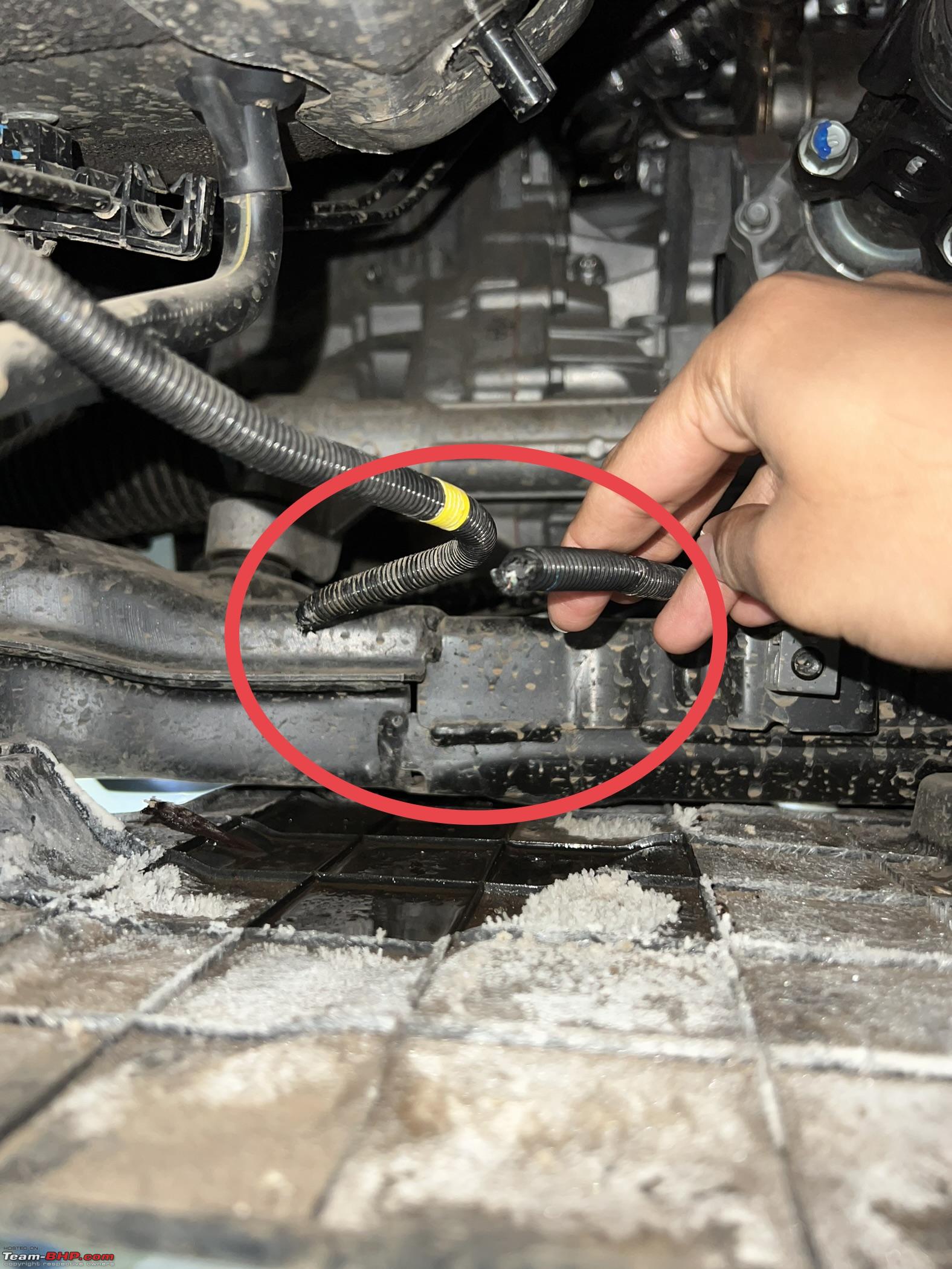

Originally Posted by 992TurboS View Post
My Tucson has been a victim of rat attack!
Possible Solutions(?): The service center has placed an order for the AdBlue line tube, hopefully that should solve the problem, the advisor mentioned that the part costs approx. Rs. 16,000 and may need up to two weeks to arrive.
"Check Urea System" message popped up every time.
It was frustrating for not being able to drive the car for almost a month. One of the biggest drawbacks of CKD cars is the availability of parts. After quite a delay, the "Urea Heating Tube" arrived after three weeks, granted that it's not a regular wear and tear part and lasts during the car's entire lifetime. I was told not to crank the engine until the parts arrived. Made sure all the cars have rat repellent applied to the entire engine bay. The car was tethered to a trickle charger for few days, preventing it to run out of battery power. After I get a call that the parts have arrived, I immediately called RSA and a flatbed arrived at my doorstep within 40 minutes! Very quick I must say.
ASS evaluated if there are any other issues and they started working on the car, noticed that the tube had couplers, they quickly swapped it with the replacement part and ran the diagnostics.
ASS ran the diagnostics and the error went away. Test drove for ~50km and the car was back to normal. They were prompt and fixed the issue in no time, only had to follow up about the part availability a few times. Touch wood, everything is working fine!
Originally Posted by KrishKallapur View Post
There is a Hydraulic Hose protection wrap available in the market. 2 types - HDPE and Metal sleeve. Both protect well.
I thank you once again for your suggestion, I'm considering getting it done for all the cars to prevent rodent issues asap!
992TurboS is offline   (7) Thanks
Good to read your car is back on road. In addition to protecting, couple other things which worked for me- 1. Make sure the place where you park is well lit. Especially ground around the car with good light.
2. Put some small tobacco bags in the bonnet and in the parking area. Nice and rat hate it.
I am also looking at a floor fixed electric fence around the car.
KrishKallapur is offline   (1) Thanks
Happy to know that the issue got fixed finally. But that is the caveat too, right? The part might last for entire car's lifetime - but such own damage (insurance own damage category I mean) incidents make it not so rare a part to fail. More than a month is worrying - despite Hyundai backing.
vinodvayyat is offline   (1) Thanks
Thank you! Fumigation around the parking and my house was duly performed and did not notice any rat nuisance since then. I've read about tobacco packets too, but found it risky to keep them in the bonnet, maybe putting them near the car might help, will update once I get to install the hose protection wraps. Thank you!
Thank you! Of course, I was mentally prepared that it may take a while. The parts arrived during 2nd week of January in India, and the shipment was delayed due to Pongal festival in TN by 4-5 days. It was mentioned that the part would arrive within 2 weeks in MH, a little earlier if it's just a regular wear / tear part. The urea heating tube is a part of SCR (Selective Catalytic Reduction), applicable for cars with diesel engines, designed to provide heating for AdBlue supply tubes in freezing temperatures. These parts are built to last the entire lifetime of the car. Tucson NX4 diesel is available only in select countries, making it a little more difficult to get them timely. Unfortunately, the rodent targeted the very specific part. So yes, it was wishful thinking that it was just a regular wear / tear part and it would arrive within two weeks. That's a compromise I was / am willing to make for a CKD unit.
992TurboS is offline   (2) Thanks
Sorry to hear about your ordeal. I hope you are using insurance to cover the expenses. This might of use to you though it might be a pain to remove it and place it back. Also get the underbody sprayed with rat repellant like Autoguard (Protecting cars from the RAT menace - Autoshine Rat Spray (Mumbai)). You could ask the service centre to spray the repellant or go directly to Autoguard consdering you are in Mumbai. A can costs rs 1950 and is quite effective.
If possible have the service centre cover the hose with a wire mesh. But rats attack a single mesh to as well in my experience so it needs to be a double mesh and secured properly. One more thing which works for me is water mixed with the common dettol antiseptic, only it is effective for a few 2-3 days and needs to replenished. Also it should not be sprayed on any of the engine components. I pour some over the plastic engine guard at the bottom which keeps it clean and free from rats.
If all fails please get pest control done and they will get rid of the rats. If you want to do it yourself "Roban" poison cake smeared with "Ratol" posion paste is highly effective combination and I have seen rats die within two days of consuming same. Make sure it is not kept anywhere near pets and please wear gloves and mask as the fumes of the "Ratol" paste are not really good to inhale. The paste should also not be touched by hand without gloves. This should be your last resort.
Good luck.
Need a really good solutions to protect my other cars from rodent attacks
My 2 previous cars have been victims of rodent attack too. And the only thing that has ever worked for me is to start and move the car every single day or at the maximum, with a day of gap.
Tobacco leaves, Anti Rodent Spray - nothing deterred the large rats of my locality. And I didn't want to try the mesh.
msarunms1987 is offline   (1) Thanks
Have noticed recently, a lot many new car users installing a device under their bonnets next to the battery. Seems to help and completely no nuisance installation.
https://carcat.in/?gclid=CjwKCAiAuaK...xoC31cQAvD_BwE
