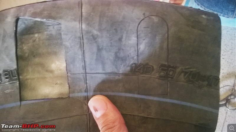

Can you share a picture of the rubber cap (dust cover), am curious to know how it looks as its missing in my S1.
Dear Sagar,
Please find the pic:
The FIAT 1100/Premier Padmini Technical Information thread-photomagic110.jpg
The circle you can see, was where the stitch was, the half torn rubber sheet that was sewn to this one was discarded. The idea is to get another rubber sheet from a discarded tube, and use Fevicol SR adhesive to join them.

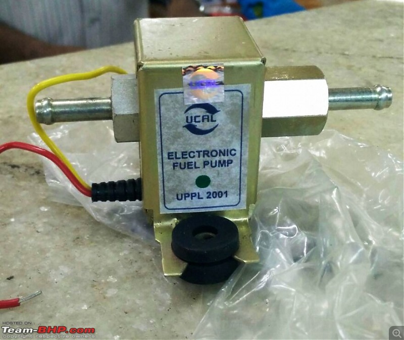

Can someone tell me what make fuel pump came in my 76 padmini, I want to pick up a rebuild kit.
boeuff is offline   (1) Thanks

Dear Boeuff - the car came with a "SOLEX" pump made by Carburettors India Ltd. Subsequently the name changed to "IBEX" but the product remained the same. Why do you want to change the kit? What has happened? Has the diaphragm punctured? If yes, petrol will mix with engine oil as it will leak past the diaphragm and enter the sump. Check for petrol smell on the dipstick and increase in oil level.
Best regards,
Behram Dhabhar
Dear Behram Dhabar, Thanks for the information.
The problem that has been there for a while is if the car has not been started for about 2 weeks, then it takes a few cranks (3-4)to fire up.
It starts with half a crank if used more frequently. I was hoping to clean the fuel pump valves to see if that will fix the issue.
I don't think the diaphragm has a problem as no petrol smell or oil level increase seen.
Before I touch the pump, I wanted to make sure I have a kit.
I am also considering installing an electric fuel pump. Any thoughts
Dear Boeuff,
4. Maruti Omni fuel filter added before the electronic fuel pump inside the spare wheel well, same as in all my other cars.
I intend to move to this setup as well, we can source the fuel filters and pumps. I dont remember which electronic pump to buy though. Also have to see how to wire it. Also, should the electronic pump be used only to start or its operational all the time?
autocrat is offline

Originally Posted by autocrat View Post
Dear Boeuff,
Ucal fuel pump is what you would buy,
Someone has picked up one for me from Coimbatore.
I thought there was a detailed post somewhere on fitting it by Behram Dhabar?
The FIAT 1100/Premier Padmini Technical Information thread-image.jpg
