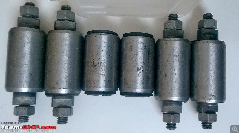

2) Rear suspension bushes (not sure where the ones without bolts fit)
The FIAT 1100/Premier Padmini Technical Information thread-wp_20150806_21_42_27_pro.jpg
The FIAT 1100/Premier Padmini Technical Information thread-wp_20150806_21_42_41_pro.jpg

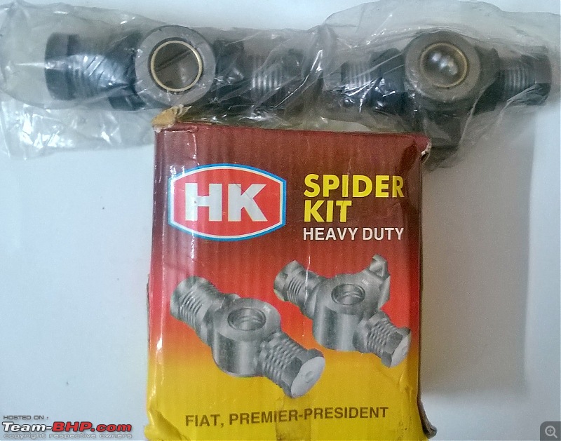

4) Spider Kit (i don't recollect this brand being even discussed on this thread, but even "Ganes" brand was not available. I am not sure if the car needs it right away, but felt its good to have as a stand-by for any emergency.
The FIAT 1100/Premier Padmini Technical Information thread-wp_20150806_21_47_46_pro.jpg

Dear Gowtham - the suspension spiders that you have purchased are not original, please return them. Please DO NOT use aftermarket spiders, the material will not take shock load! In your car, the front suspension seems to be unopened and therefore original, nothing needs to be done immediately (refer underlined note below). PLEASE DO NOT OPEN THE SUSPENSION, NO MATTER WHAT ANYBODY TELLS YOU. DO NOT DO ANYTHING SILLY ON YOUR CAR! Setting the spiders is a specialized job, the tolerance on the OD is 24 microns, 99% of the guys do not understand what to do, they will spoil the stub axles.
The Lucas TVS coil is OK. The VIR leaf spring bushes are OK, the ones with the nuts go on the rear side. The EMA suspension rubber bush kit is OK.
In case of the battery also, you should have gone go through a simple process of elimination. Without touching the alternator, just put a "service battery" from the friendly neighbourhood batterywallah and use the car for a couple of days. If it works, the old battery was a dud. Also measure the specific gravity of the electrolyte by a hygrometer. It must be 1.2 in all cells. Its so simple, but friendly neighbourhood batterywallahs will forever remain ignorant of simple things ()! This is nothing new for me, I just quietly do what I have to do and find my own way, you'll have to do the same. Please post photographs of the new Amaron battery, I want to see whether it meets JIS-D-5301 (JIS means Japanese Industrial Standard).
Note: Get the lubrication done, no compromise on grease quality.
