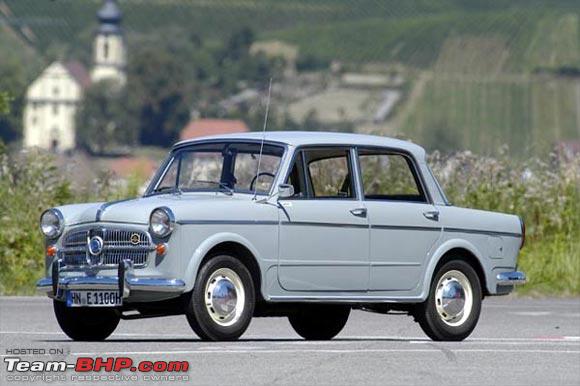

My little contribution towards colours that would look good on your car. Yours to choose from.
This Neckar just needs a white top matching with the colour on the rims.

This red would do well with a white top too, same colour as on the rims
Or any of these
