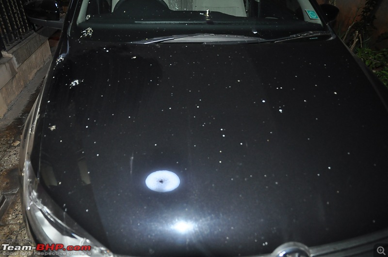

While I enjoy bird photography and to an extent bird watching, they clearly don't seem to like my car be clean. Look what they did to the poor thing when parked under a tree for 6+hours!
It was 11pm when dad got back home and I saw this! Initially, thought I'll use ONR+MF+water and get rid of it, but looking at the amount of bird dropping and the fact that it had dried, decided to give it a wash.
While drying the car I noticed the bird poop had left behind marks which wouldn't go even after a shampoo wash. Does it mean that the poop ate through the paint sealant and onto the clear coat ?

Poop cant eat through clear coat so fast. Its just the acidic residue of the poop which is strong enough to bond to the CC thats resulted in those marks. Try Vinegar in 1:1 with water.Soak a MF dipped in this solution and allow it to rest for sometime over the spots and then try to wipe them off.If that does not work out then Ultimate compound will be your best bet.
BTW Happy Detailing

Thanks mate! In that case,looks like the paint sealant did its job and protected the paint. Will try out the vinegar+water combo, if that doesn't work will have to wait till November to get my hands on UC

^^ You can also use a locally available sonax polish to remove that stain , it contains light abrasives which will do the job perfectly !!

Try claying once. Maybe it can remove those stains
Seems to be a war between birds and das auto and birds won by 1 : 0.
You should use ONR in QD form 1:16(ONR:Water) and spray it over the paint profusely and wait for sometime and again spray all over again. Wipe off with a clean MF and all the stains should go.
I too park my black vento in open for 7 hrs and some how some birds do poo over it and due to heat it all gets baked very hard. I follow the same process as above after coming back and see to that all of is removed.
Since bird poo is very very acidic and starts chewing through clear coat as soon as it falls on the paint. Always advised to have it removed ASAP for better life of paint.
