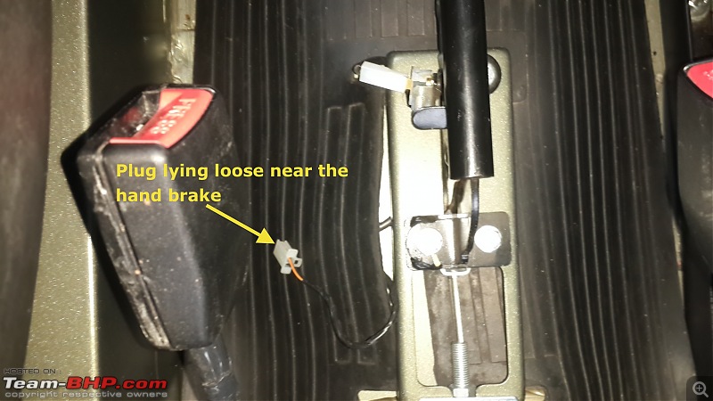

Hey guys,
Noticed a couple of loose plugs in my Thar.
The ASC has no clue.
Kindly refer to the pics and advice.
1. The first plug is lying idle next to the hand brake, with no socket in sight.
Mahindra Thar : Issues & Solutions-20140718_162410.jpg
2. The second one is below/behind the glove box. There is a socket visible there but haven’t plugged it in as I wasn’t sure what its for.
Mahindra Thar : Issues & Solutions-20140719-19.48.47.jpg
Please help.
Thanx.

The first one is for the seat-belt warning light, there is a light in the instrument binnacle, but not connected! Not is there a provision in the seat-belt clip to connect the socket!
Thanx for the help,
Does this mean, that if I replace the front seats with that of Innova then this feature can be made use of?
Thanx.

Just leave it there, the wire harness used is common with other Mahindra vehicles ( Bolero Models ) do not worry I have tested with a multimeter to take power for a GPS unit and radio unit ( Walkie Talkie ) there is no current there. Therefore I installed a 12 V lighter socket in the central panel of the dash from a connection left idle for stero units.
You will find more inside the dashboard. They can be put to use later. Just push it under the mat.
