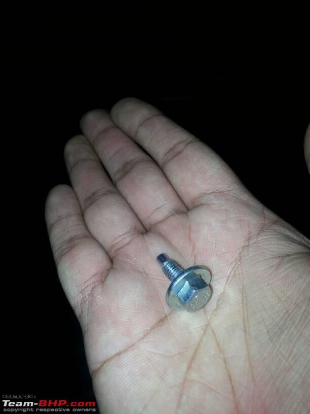

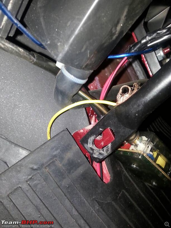

Now this is one bit that annoys me no end. Why should it be acceptable to thar owners that screws and nuts and bolts should keep falling. I can accept a lot of anomalies as the JeepThing, but this certainly is unacceptable. This one fell off from behind the dash board - this one is crucial as it supports one of the two bars supporting the lower part of the instrument cluster. Notice how the screw is shaped. I am now thinking of supporting with a nut from behind. As of now, there is absolutely no support for this screw and thus, it unscrews itself with all the vibration. Minor crib again but I dont think anyone in their right mind would want us to find this acceptable.
