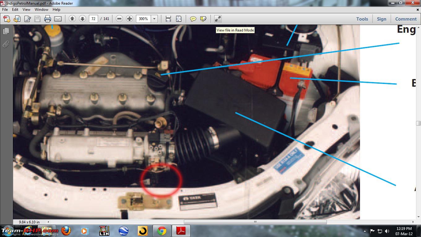

Gentlemen,
I have a strange sound coming from my Tata Indigo (MPFI-2005), 75000+ KM run car. I maintain my car well. For last three or four days I am getting a strange noise coming out when the car is sufficiently cold. The noise goes off when I twist the ignition key, even if I do not crank it up. The noise is rhythmic, possibly originating from three places in the car. It has a breathing like hissing sound, which has also got a whistling tone and a krrrr krrrr sound mixed with it. The hissing sound is possibly coming out from near the throttle, the whistling sound is coming from somewhere near the fuel pump and the krrr krrrr sound is coming from here:-
These three sources of sound are all beeping at the same time, in a rhythmic manner, when the car is completely dead and the key is either at off position or is taken out completely. At the twist of the key the usual instrument lights glow in the dashboard and all three sounds stop. The car is behaving normally and the check engine light also goes off after starting the car. Out of these I could only positively locate the source of sound, in the place marked in the red circle in the above picture, as it is also vibrating with the krrrrr krrrrr type sound, as if something electrical is burning inside. I took my car to the TASC but the car got sufficiently warm and the sounds stopped. The personnel there identified that particular device as idle motor controller switch or something, opened and cleaned it with some cleaning spray and re-fitted it back. But again this problem has come up today. Do I need to leave my car with the TASC overnight for the problem to arise again? Any idea what may be the cause of it? The sound vanishes if the car is run for ten or fifteen minutes.
Any suggestion gentlemen? How can sounds come out simultaneously from two or three places at the same time, which goes of at the turn of the key and the car is cold? If it is an electrical fault, where should I ask the mechanics to check? Please help me to rectify the defect.
Rahul
Gentlemen,
Today I got my car back from Tata authorised service, after four days. The problem was detected to a damaged or fused electric wire which is connected to a sensor in the throttle. And as a consequence of it the idle speed controller (that is what they said) in the throttle became faulty, causing such malfunction. Wiring was properly repaired and the throttle was changed. Now the car is running fine.
Rahul
