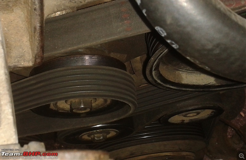

Got some work done today. Apparently the pulley bearings were wobbly, so I got them replaced. That has taken care of the squeal. But I notice the belt is still slipping. It is in the exact same position it was in before the bearings were replaced. The belt slips on the auto tensioner pulley, which I switched with the identical one below it. The mechanic says this is quite common on the Ikon, and assures me that it won't slip off completely. However, I am concerned that this will accelerate belt wear, and could still slip off completely.
I have attached a picture. How do I get this fixed? Replace the tensioner?

Re: What's that sound ??
seems like the tensioner..
The squeal came back today. I checked the alignment of the pulleys myself, with a foot-scale. It is definitely the tensioner that is whacked out. The pulley is slightly tilted. The tension on the belt is sufficient. So what would be the next step? Can the angle be set right or do I have to replace it? And if I do, what's it gonna cost me? I am not really happy with going to the A.S.C. for the replacement, even if I have to pay less. But they might be the only ones with the tensioner in stock.

I got the tensioner replaced. No difference. The pulleys are alright- no wobble, no free-wheeling. The belt still hangs a bit off on the tensioner- even my new mechanic says that's normal. The sound is driving me nuts!
The belt is not glazed, but the idler pulley is all nice and shiny-could that be the reason? Since I replaced the tensioner, the sound has lessened somewhat. I replaced one of the pulleys along with the tensioner, which was also nice and shiny, with a "rough", coarse one. I have a sneaking suspicion that it is the reason, but I really don't want to replace it for no reason. The cost of the pulley is close to the cost of the belt, and I'd rather go for a new belt. Any way to test this out before I replace it?
P.S. I'm sure this is still the belt slipping- the sound goes away when the belt is wet.

Okay, finally diagnosed the issue. I scuffed the pulleys to make them grab the belt better, but that did not help. The belt still hangs off about 1/4 off the tensioner, so what I finally did was keep the engine running, and force the belt onto the pulley with a metal pipe. That took the sound away. Belt on, no squeal. Belt slides off, squealing again. Now all I want to know is HOW to make the belt stay on the pulley in it's entirety. The crankshaft pulley, and the water pump (I think they're the adjacent ones) are aligned properly as far as I can tell. Will a new belt stay on the pulley? I reversed the old belt, and it still slides off, so I'm thinking it's not a belt worn sideways.

have checked the belts on other IKONs?? i mean i doubt any manufacturer would have designed such a lopsided pulley
Change the tensioner as it keeps the belt in check; and also change the belt as it is a consumable

That's what I thought. But you can't really argue with mechanics.
The tensioner has been replaced. Will go for a new belt if the pulleys are properly aligned.
