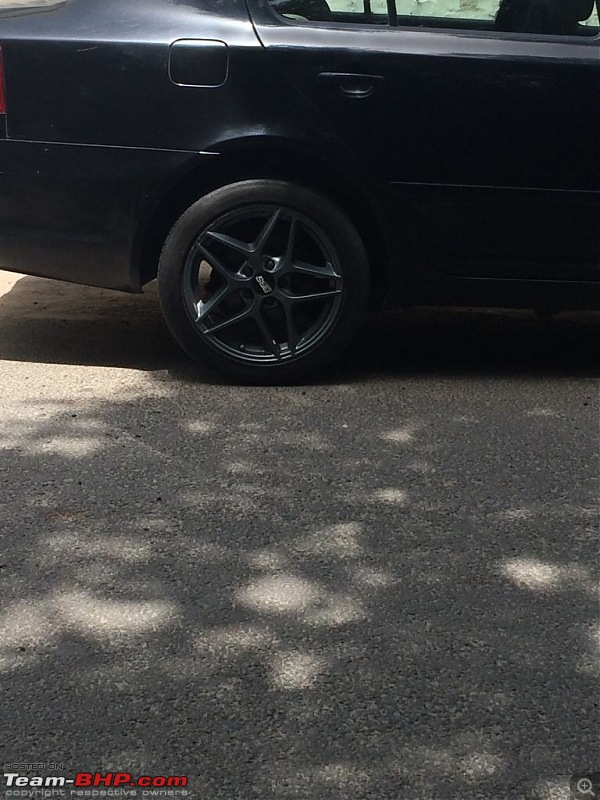

I am using stock tires on my TSI. Whats the best size upgrade, 16 or 17 and tire size?
Go for 17 bro. Here is a pic of my friends Laura running on 17 inch BBS. invest in good alloys. Momo is officially available now and you could check those out too.
Skoda Laura: Problems & solutions thread-imageuploadedbyteambhp1409148867.017569.jpg
PS: the car is yet to be lowered hence that god forsaken gap!
