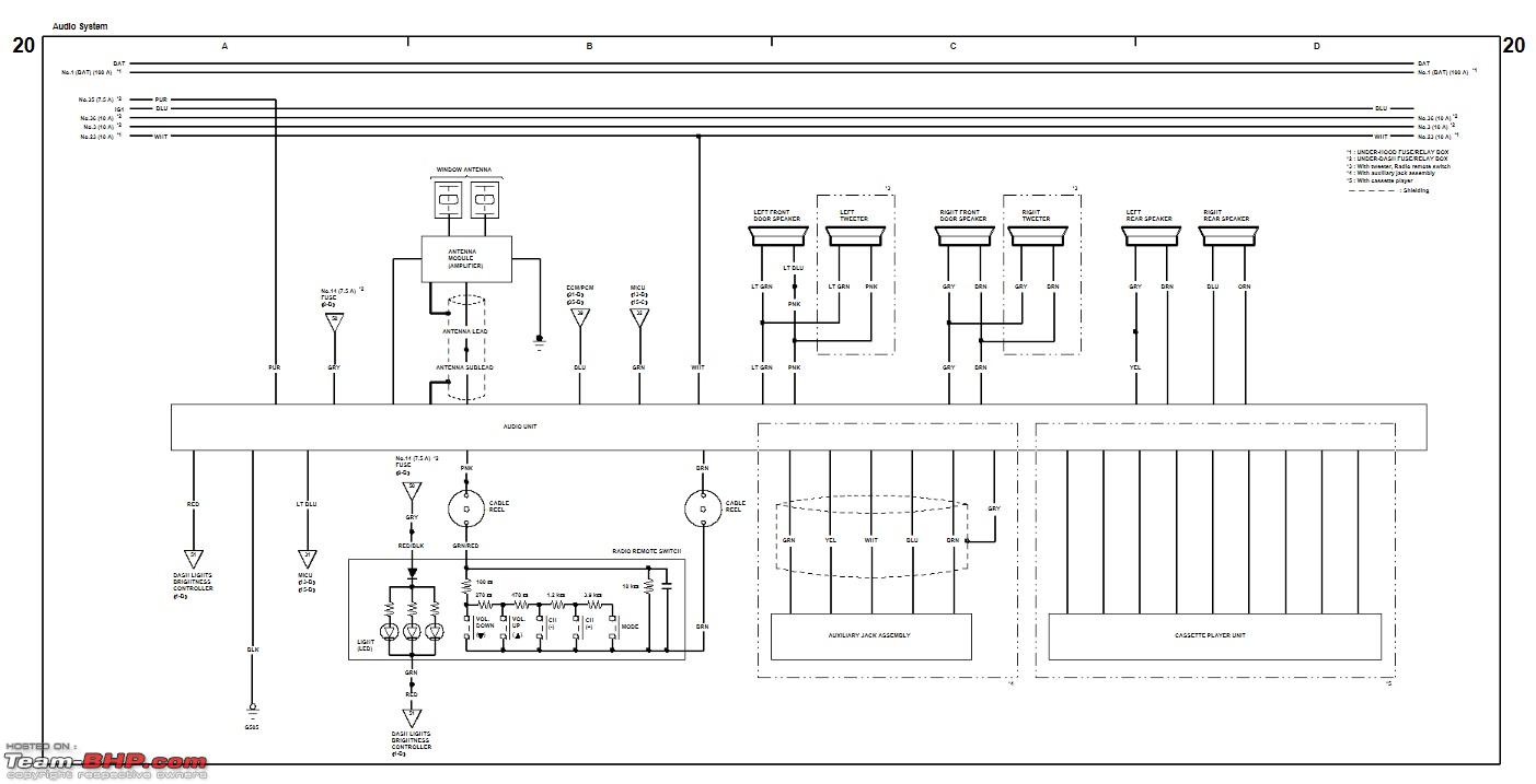

Probably lose contacts on the rear connector pins also, since the speakers are connected via these pins of the connector. Check the fuses and connector before deciding the Head Unit is bad.
This is Civic's Audio wiring circuit
Honda Civic : Maintenance, Service Costs and Must dos-civic-audio-system.jpg
You can see probably three fuses in the line
Honda Civic : Maintenance, Service Costs and Must dos-civic-audio-system-fuses.jpg
Fuses marked with *2 are inside the internal fuse box under the dash near steering and *1 is in the fuse box under the hood
I have taken a screen shot of a Civic DX manual for explanantion, please check your manual for exact location of the fuses in the fuse box.

Check these fuses, and if you probably have the spare fuses which came with the car, try checking with that to see if the head unit starts working.
Also, you can remove the stereo from the Dash easily. Please check the connectors for continuity and press them in, probably it is just that.
Else remove the head unit and go to your friendly stereo service guy.

Originally Posted by sumeethaldankar View Post
Thanks but all this wiring diagram is a bit too much for me. I took a pic of the fuse panel under the driver section. As per the net 5 is for the stereo AMP. But not sure if the factory head has a amp or if it's for the after market AMP. Either case the 5th fuse slot it empty.
Attachment 1360993
Please check fuses 35 and 14 in this fuse box.
5 is for heated seats, not available for us
