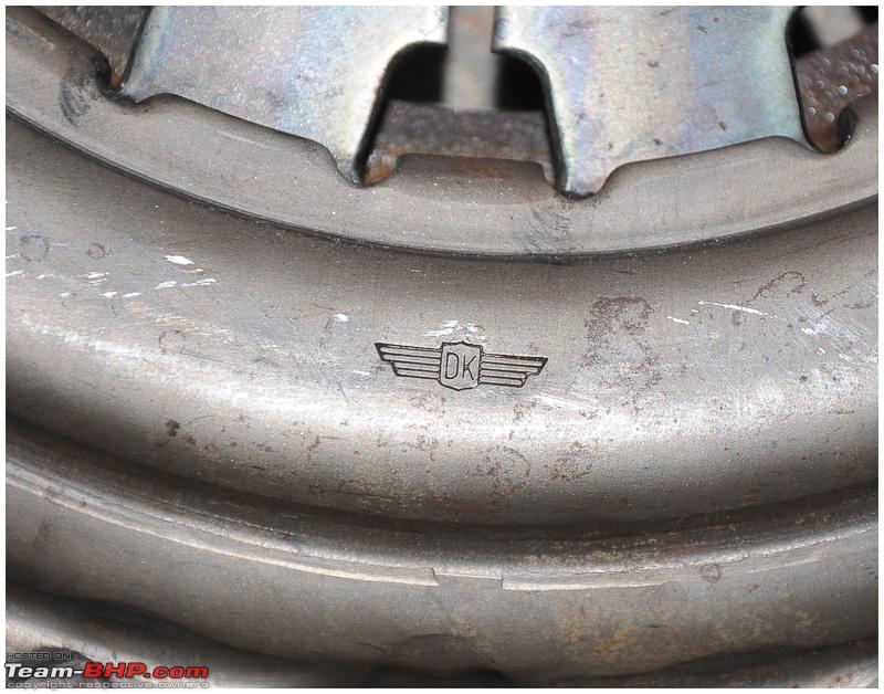

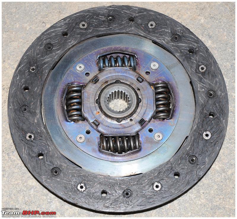

Time for Civic's clutch to be replaced, after a superb run of 1,25,000KMs.
Replaced the same at Bay6, run by my friend. Civvy is butter smooth now
OEM stock Exedy Daikin Friction Plate at 125K
Honda Civic : Maintenance, Service Costs and Must dos-dsc_8930edit.jpg
OEM stock Exedy Daikin Friction Plate Pressure Plate side at 125K. Totally worn out, rivets have come up
Honda Civic : Maintenance, Service Costs and Must dos-dsc_8932edit.jpg
OEM stock Exedy Daikin Friction Plate Fly wheel side at 125K. A little something left
Honda Civic : Maintenance, Service Costs and Must dos-dsc_8933edit.jpg
OEM stock Exedy Daikin Pressure Plate
Honda Civic : Maintenance, Service Costs and Must dos-dsc_8934edit.jpg
OEM stock Exedy Daikin Pressure Plate, Daikin Logo etched on the plate
Honda Civic : Maintenance, Service Costs and Must dos-dsc_8937edit.jpg
Exedy, Made in Japan
Honda Civic : Maintenance, Service Costs and Must dos-dsc_8938edit.jpg
OEM stock Exedy Daikin Pressure Plate at 125K, exposed rivets of the Friction Plate started scoring the Pressure Plate, thankfully Flywheel side was OK
