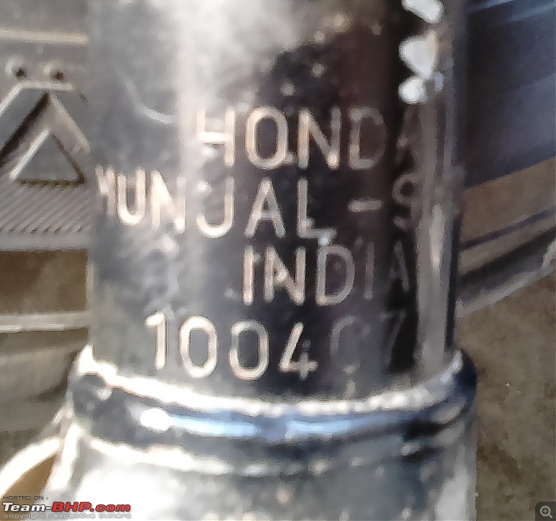

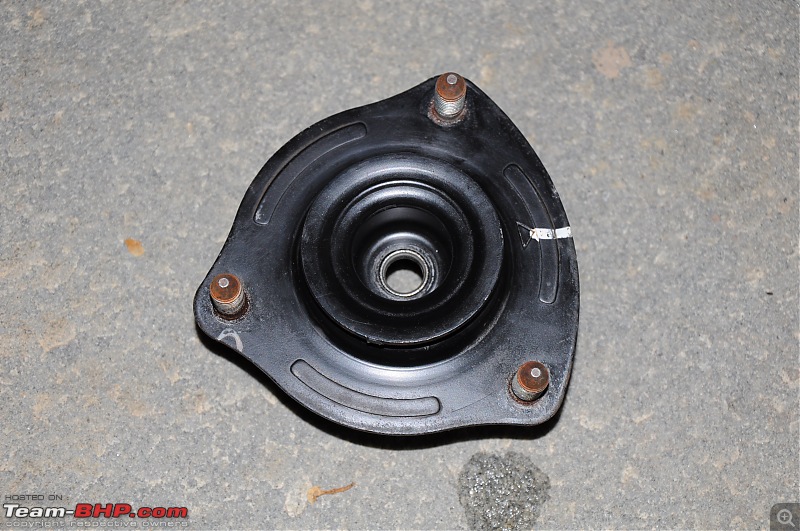

Some Information on the Front Shock Absorber
Continuing from my previous posts, let us take a look at the shock absorber components. Sorry for the quality as some I had to take with a low end mobile camera for documentation!
The Strut
Honda Civic : Maintenance, Service Costs and Must dos-dsc_0012.jpg
Check for recoil and for any leaks. After 1.25 lakhs and 8 years on all possible terrains this guy held really well in my Civvy. Check if it really needs a replacement before you agree. If you are changing to Bilsteins, Konis or Teins its a different matter altogether
The Strut showing the make - Munjal Showa

Strut Mount
Honda Civic : Maintenance, Service Costs and Must dos-dsc_8824.jpg
