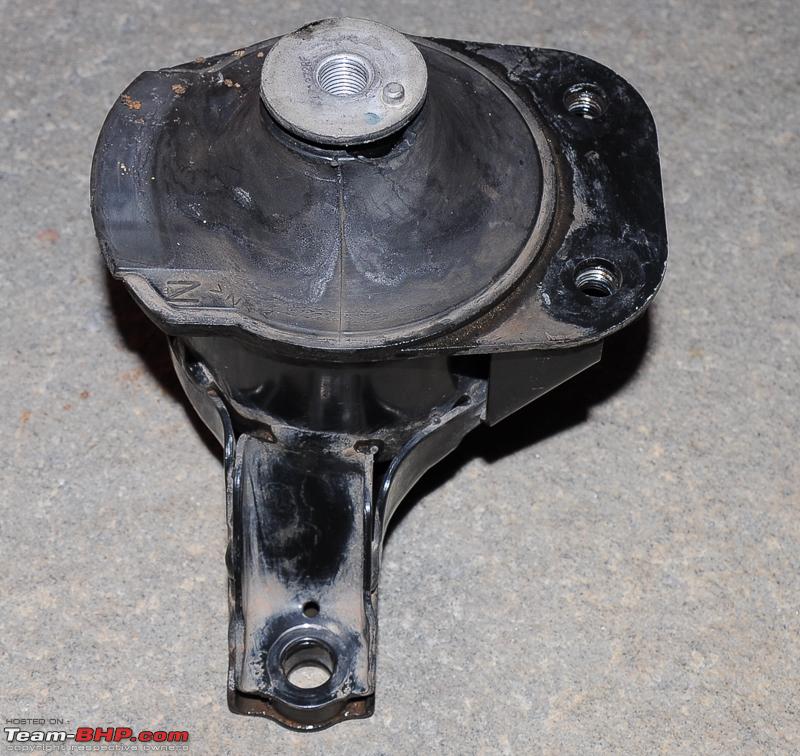

Broken OEM SNA mount featured!!

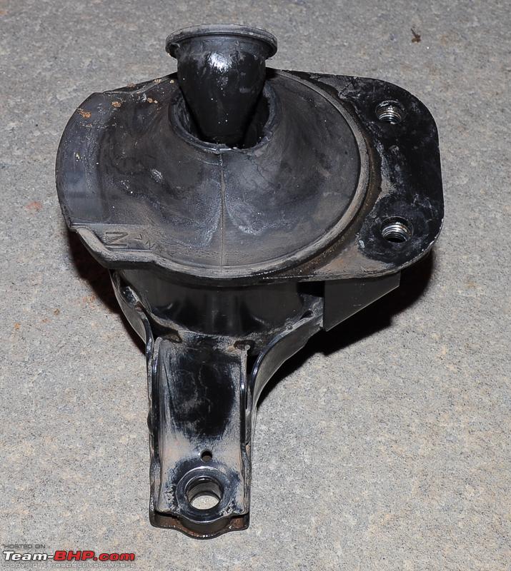

My doubt was true, there is no spring at all in this mount . After some hard physical labor I decoded what constitutes this mount!!
The rubber top of the mount cut off

The rubber completely removed, was pretty difficult as it was strongly stuck to the walls of the cylinder

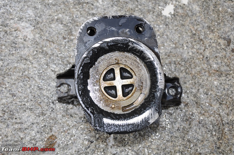

Now you can see traces of oil, yes, this is a hydraulic mount

The alloy piece removed
Top of the alloy piece
Bottom of the alloy piece, you can see the rubber seal

You can see a rubber seal below

This is also submerged in Oil

So the mount is basically two alloy pieces submerged in oil, locked and topped by a rubber part!!
