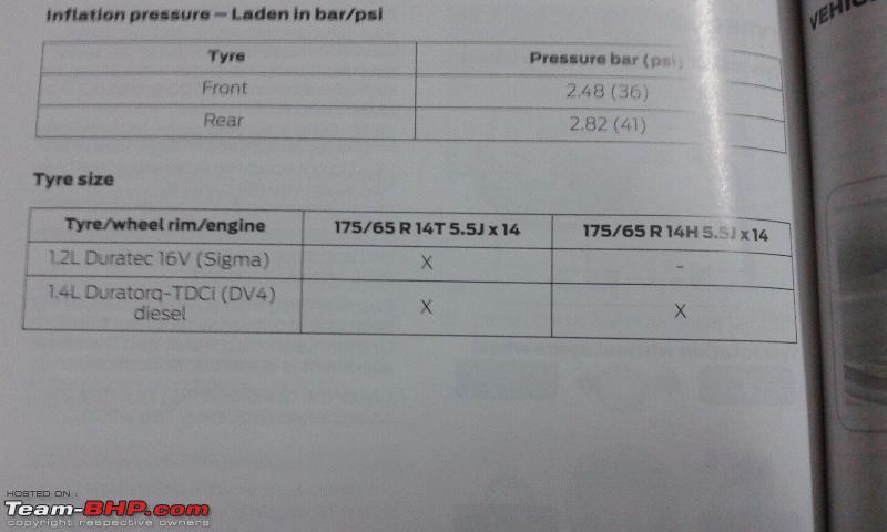

Even I had similar plans when I bought my Figo but then i read lot of positive reviews about APollo acceleres on TBHP and asked the dealer to provide me with a car that comes with Apollos. Saved me some money. My experience with Apollos is pretty good in terms of grip. They are definitely more noisy than XM1+ on my other car but not a huge gap. Overall satisfied.
Incase you want to upgrade to XM2s go for 185 width. Definitely will help the overall dynamics of the car in terms of more grip, better look, slightly less tire noise and more comfort as they would be softer.
Cons might be little redux in fuel efficiency but would be hardly noticeable. Michelins would wear little faster than Apollos being softer.
Btw, 175 to 185 width for just Rs 50 more? seems low to me cause when I had bought XM1+ the same were costing about Rs 500 more per tire.

Yes, only Rs 50 more per tyre. But does the manual mention this profile too? I was a bit worried about warranty.
This apart, there will be a speedo and odo error of 2%, with marginal increase in hardness of steering and negligible drop in FE.
But positives are better grip, handling and increase in GC by 4 mm approx.
Can you please refer to your manual and get back?

IMO, XM2 185/60/14 which will have 1% speedo error and will be better than 185/65/14. And if you do not care suspension and steering warranty, go for 185 spec.
A tyre dealer in Bangalore quoted Rs.1500/- per tyre about 4 months back for 185 mm XM2 with exchange of MRF ZV2K.
On standard tyre spec, refer picture below.
Originally Posted by r_devakumar
However, i don't remember this size is mentioned in the manual and may void warranty. In my case, the dealer noted this as non standard (apart from the tyre, i changed the alloy also outside). I don't know the impact on not having the warranty (what type of issues will not be covered because of this).
Upsizing tyres void suspension and steering warranty. I did not upsize as I read about some Figos had steering rack issues. Refer below pic for standard tyre specifications shown in the manual.

I agree with High Octane. As per user manual there is no 185 recommended hence not covered in warranty. However honoring the warranty is within dealer's discretion and you basically need to be on good terms with him. If the service dept incharge is ok with it, then you are covered. In bangalore one of the dealer was very stingy and wouldn't agree for even upgrading the horn while the 2nd one was very open and said just dont cut the wires and you are ok. So basically its a bit of a grey area.
