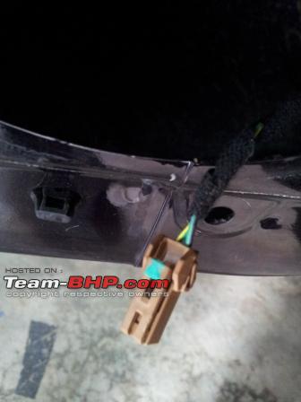

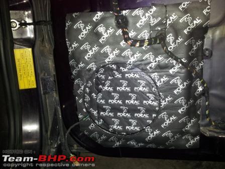

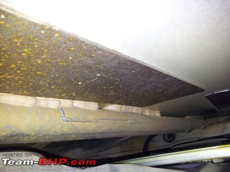

Door Damping Snaps
Am Attaching Snaps of the Door Damping.
Do note:
1) Two thick Side Impact Rods per door.
2) Existing Damping sheets that TATA provides on the Aria seen in some of the snaps.
3) 6" Speakers for all 4 doors. Front door tweeters are in 1 pillar, and for rear there are part of the speaker.
4) Note the Speakers are from Malaysia not China. 4 Ohms 25W as is standard.
5) Focal Door Damping sheet is 6mm think it has a layer of alluminium sheet embedded within.
6) Sockets of the speakers are unique and different for front and rear. If one wants to do a socket only installation without cutting wires with new better speakers then one can remove the new speaker sockets and solder the ones on the Aria speakers to avoid any wire cutting. The Aria speakers are screwed into the template that fix them into the door so the same template can be used for the new replacement speakers. - Next task for me.
All Snaps taken with Samsung SII Mobile in low light.
