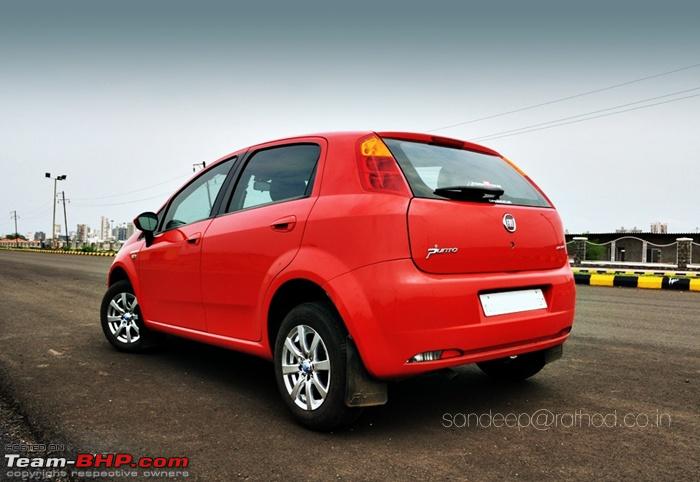

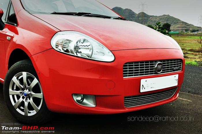

I had a look at Sandeep's alloys at yesterday's meet. They look really rich, the Sai Alloy wheels are really great. I think he got them shipped directly. Check with him for further details.

Here's new shoes for my GP MJD 1.3. Got it from SaimagWheels, HRS - H 325, 14" 98 PCD.

hey Sandev, nice Pick dude. Goes well with the colour of your ride.
Are you running on OEM rubber or you upgraded them as well ??
Rubbers are same, it will last another 10k. Will upgrade later, once it becomes must.
