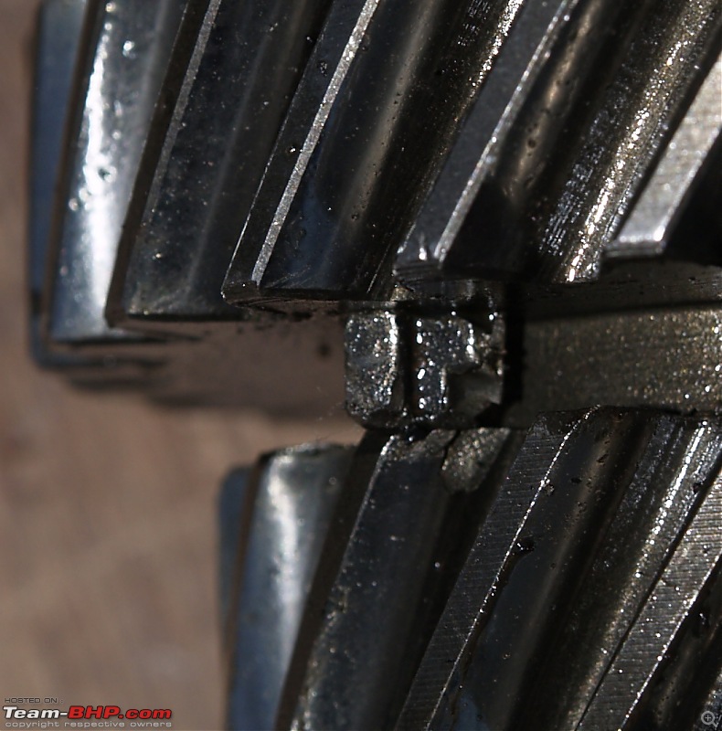

Here are some gear parts I replaced, I can't recognise all the parts.
Here are 2nd, 3rd and 4th gears, not sure which is which.

Notice the damage closeup.

Dear Sharath - Behram here - your gears have pitted on the tooth flanks which clearly indicates lack of lubrication. Unlucky for you. This is what happens due to total apathy on the part of the owner. I see it all the time. Sad but true that the previous owner did not care for the car properly. The factor of safety of the KMT90 is so high that nothing should happen in normal course. By the way, the "Umm what is this?" is the transmission input shaft. I am glad that your car is in the safe hands of Richie's team. I'll try and meet you when I am in Mangalore next time.
