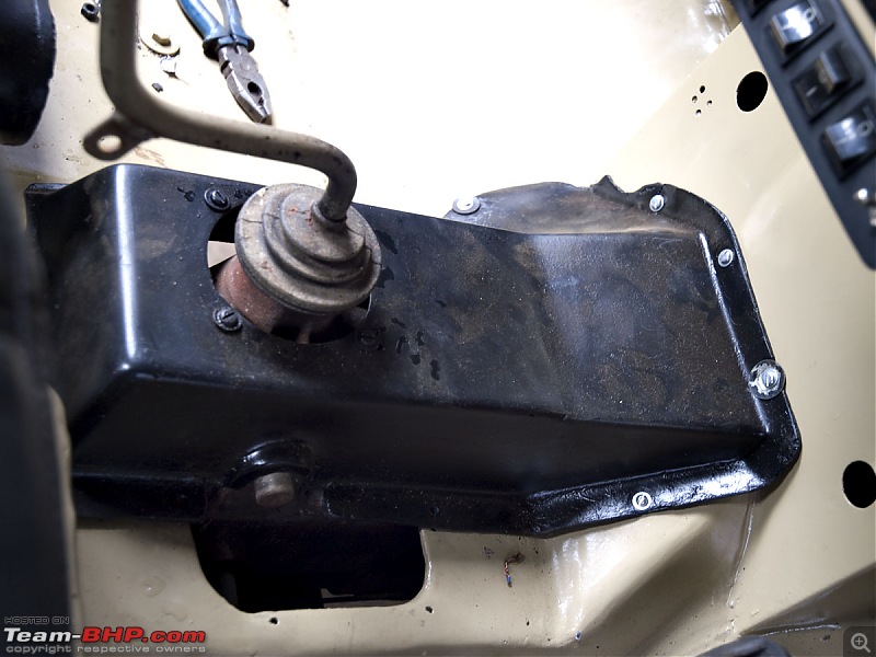

Now the hood can be locked.

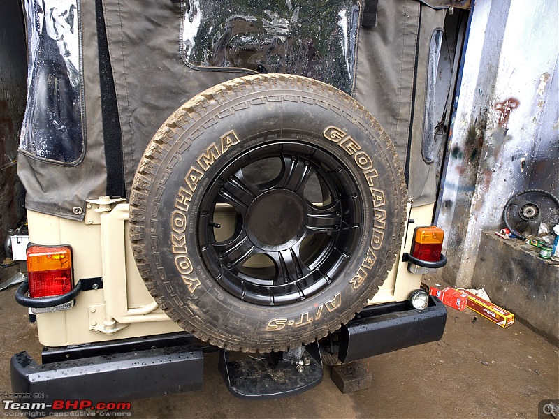

Spare tyre lock (lock will be behind the tyre)

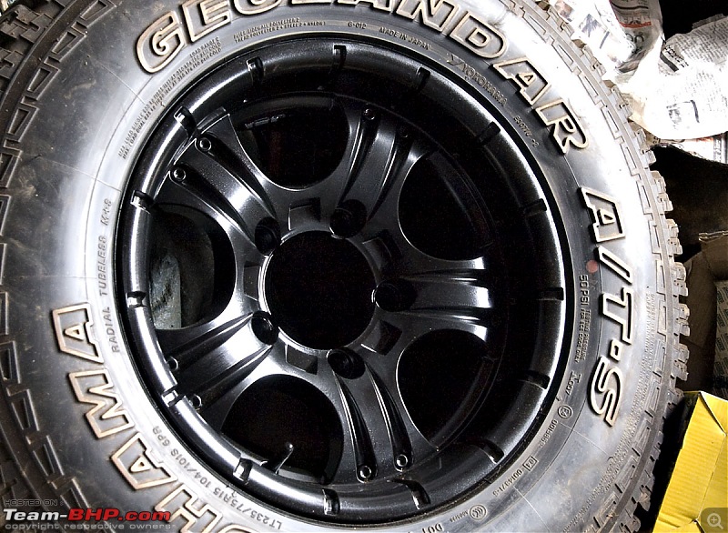

Black color alloy

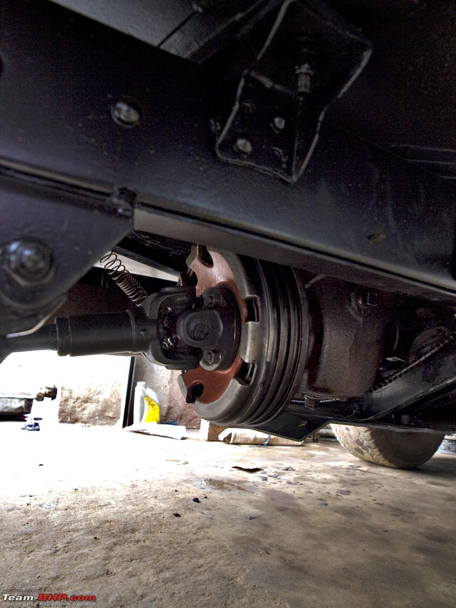

Gearbox sealer

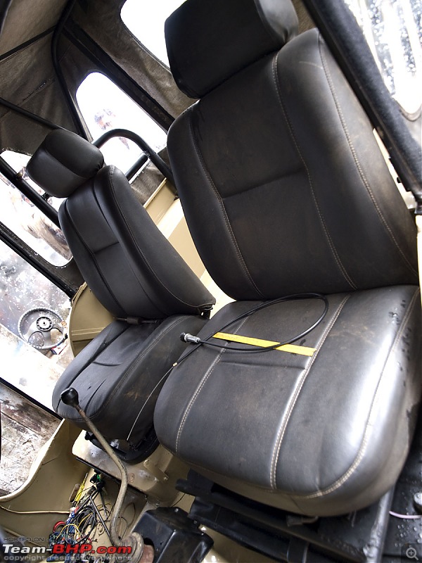

Same old seat, no reason to change. The fast idle cable you see on the seat was donated by Viji in December after Kakkabe OTR.

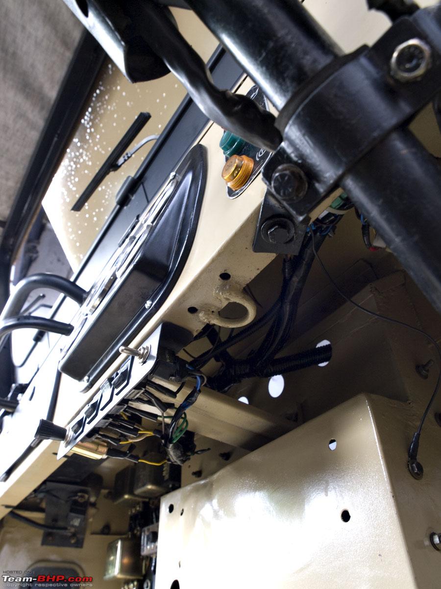

This should give an idea where the fusebox is located.

Extra hook under the dashboard for steering locking with a flexible cycle lock.

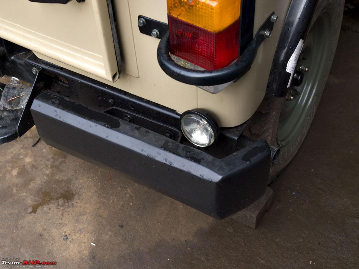

The reverse light may get slightly blocked by the bumper. Might need relocation later.
