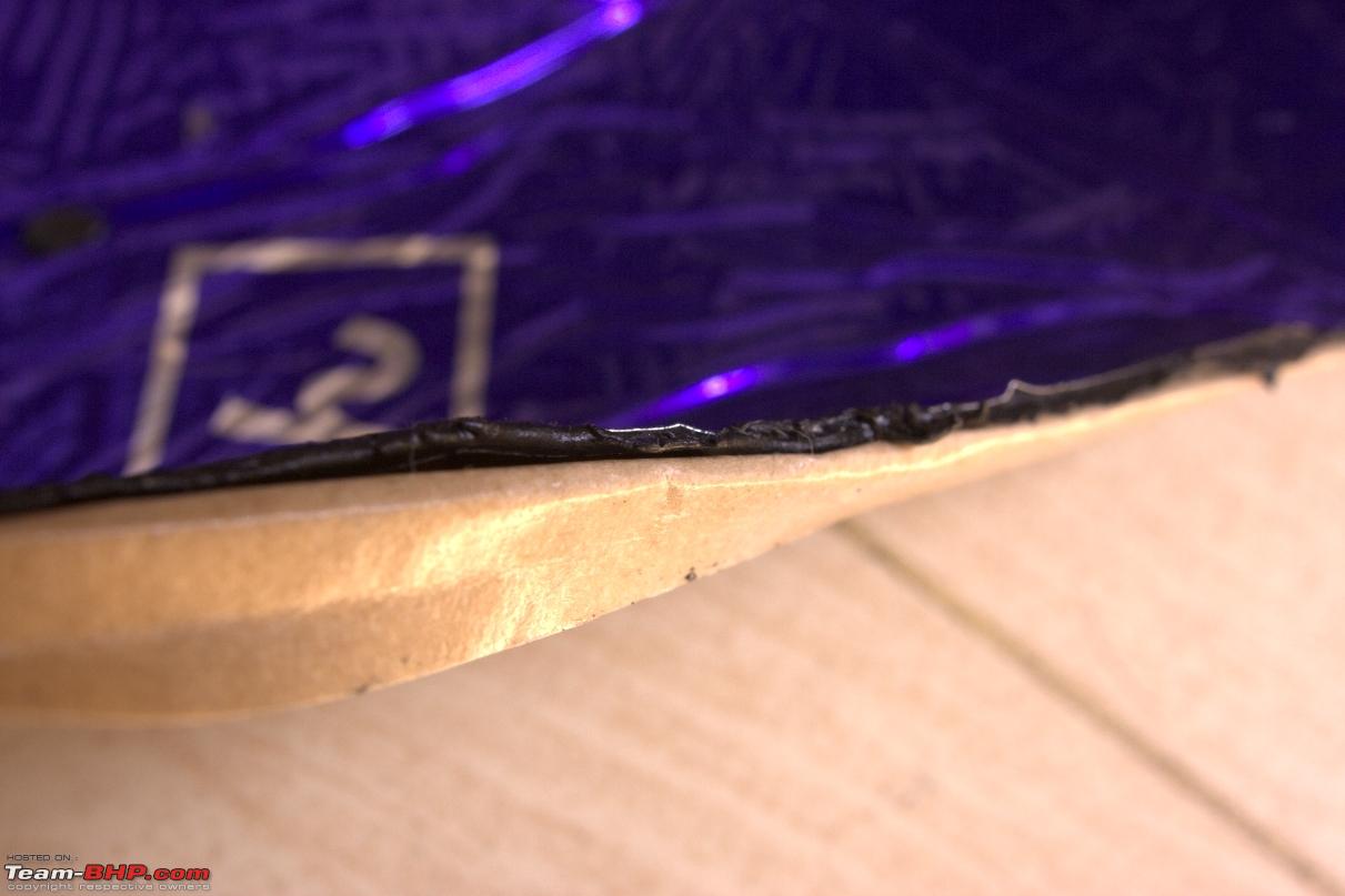

The Aluminium-Bitumen based sheets, each tile in the bg is 2x2 ft
Correction, please read the above as Aluminium-Butyl based sheets.
Now time for results.
Cost for 8sqft damping sheets + 9 sqft deadening sheets + turpentine + Cotton waste + Scissors + Screw driver set = 6000Rs
Damping inner-side of the outer wall+Deadening outer-side of the inner wall of the 2 front doors and deadening outer-side of the inner wall on 2 rear doors.
Bruises and stains are bonuses.
Front doors are heavier, plastic panels on all 4 doors feel more tightly fitted.
Rattling reduced noticeably,definite improvement on the overall SQ from the components, noise reduction is nil .
Audio test done using the following track-list. A State of Trance 2008 - Wikipedia, the free encyclopedia
Volume 30 was unplayable before the DIY, with heavy distortion on bass notes due to the rattling door panels and windows. Rattling door panels are a thing of past now, but there is some resonance at higher volumes for sustained bass notes from within the door. I think i should have put one layer of damping on the outer-side of the inner wall underneath the deadening sheets. Not sure, this might be even due to the power window fittings, which can't be damped AFAIK.
Knocking on the front door outer metal feels less hollower than on the rear doors, which dint get any share of the damping sheets.
