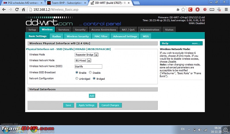

Originally Posted by Ferrari1976 View Post
@diyguy
I have Asus RT-N13U on DDWTR being used as a repeater bridge. But it too keeps on dropping the link to the main router.
What changes have you done to avoid this?
Thanks.
Here are the settings for my router.
Note that Starlife is the SSID of my original network and this router also broadcasts the same SSID. In the security tab, i have put in the same settings as the original router (same encryption and same password).
The rest of the setting were done according to the dd-wrt wiki
