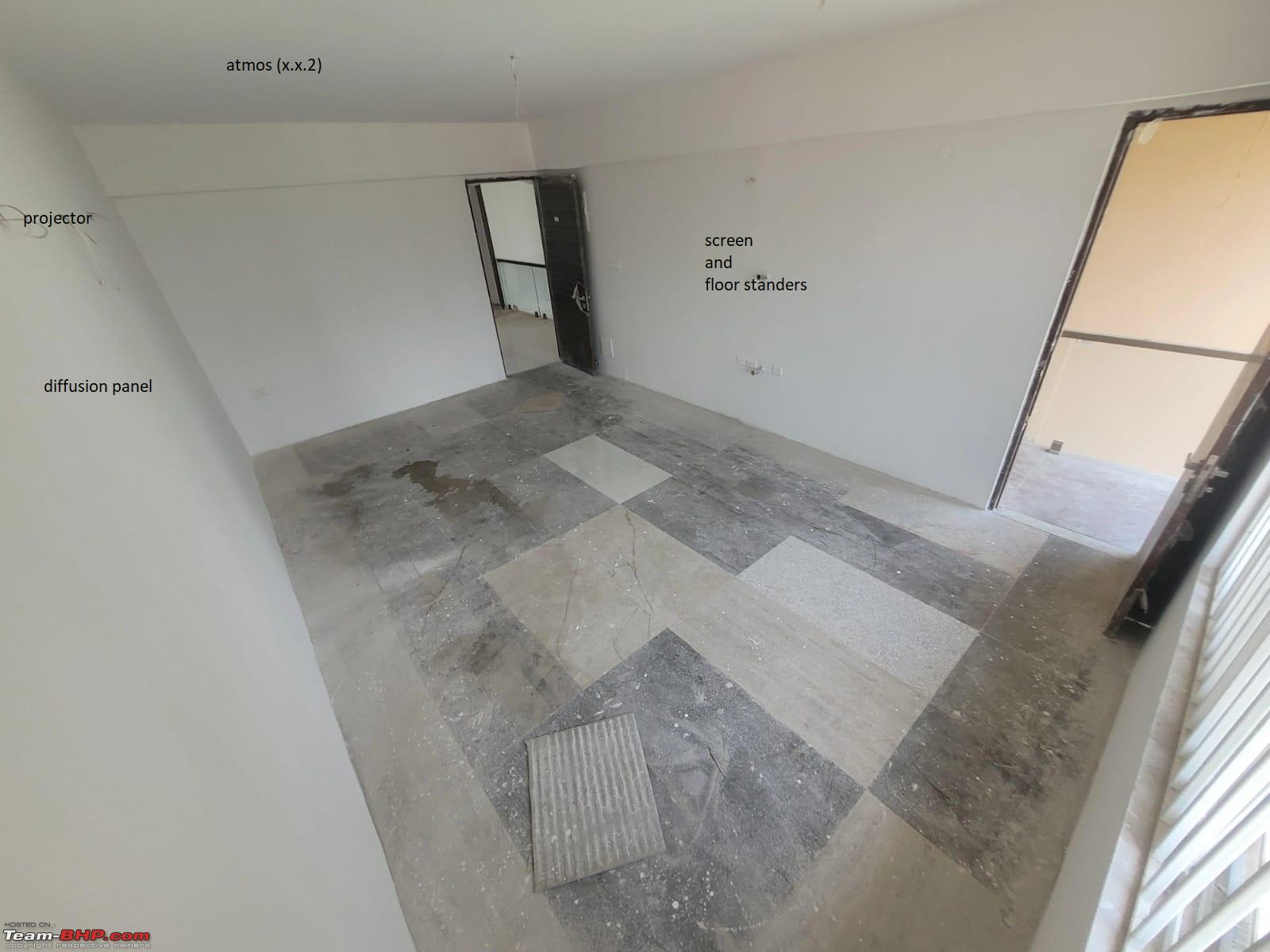

This is my room.
Using rockwool and foam to treat all sides.
And then the wall behind the seating /listening position will get a 10x2 feet diffusion panel.
Will the room be too dead?
7.1.2 Elac Debut F5.2 and Pioneer 9 channel AVR. Don't know the model number yet.
1) You are good with any decent 7.2 Amp
Unless you have near future changes in view, the Dolby 5.1.2 spec will suffice for the distance you are at. (Less is more logic here, you are quite close to all speakers.)
2) Tackling the room acoustics, a bit.
yes. please avoid covering all sides with foam.
- Absorb around corners of rooms + diffuse around speakers (especially rear).
- Absorb behind the front speakers.
- Keep subwoofer out of the cabinet.
- Rugs on the Floor.
This shall be more than sufficient considering the dimensions.
You would need the room to reflect, damping it all is totally detrimental.
