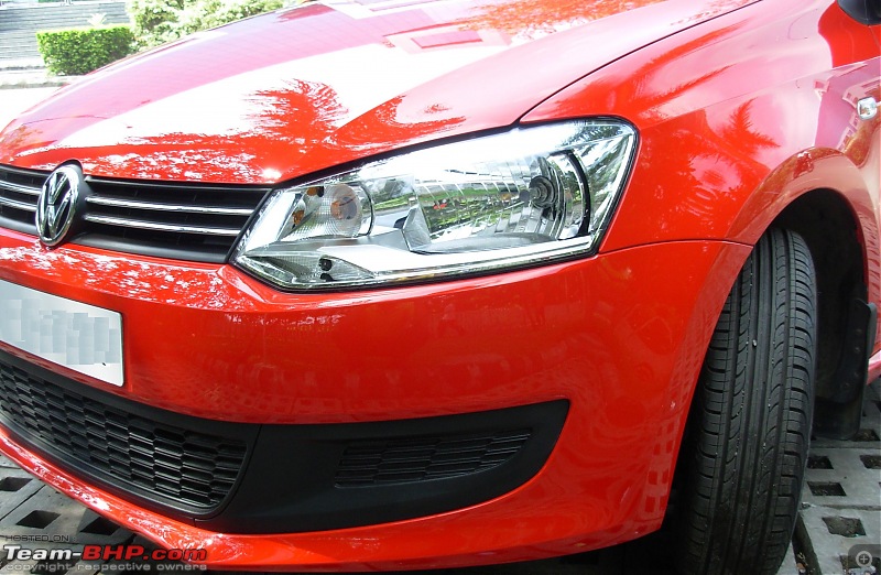

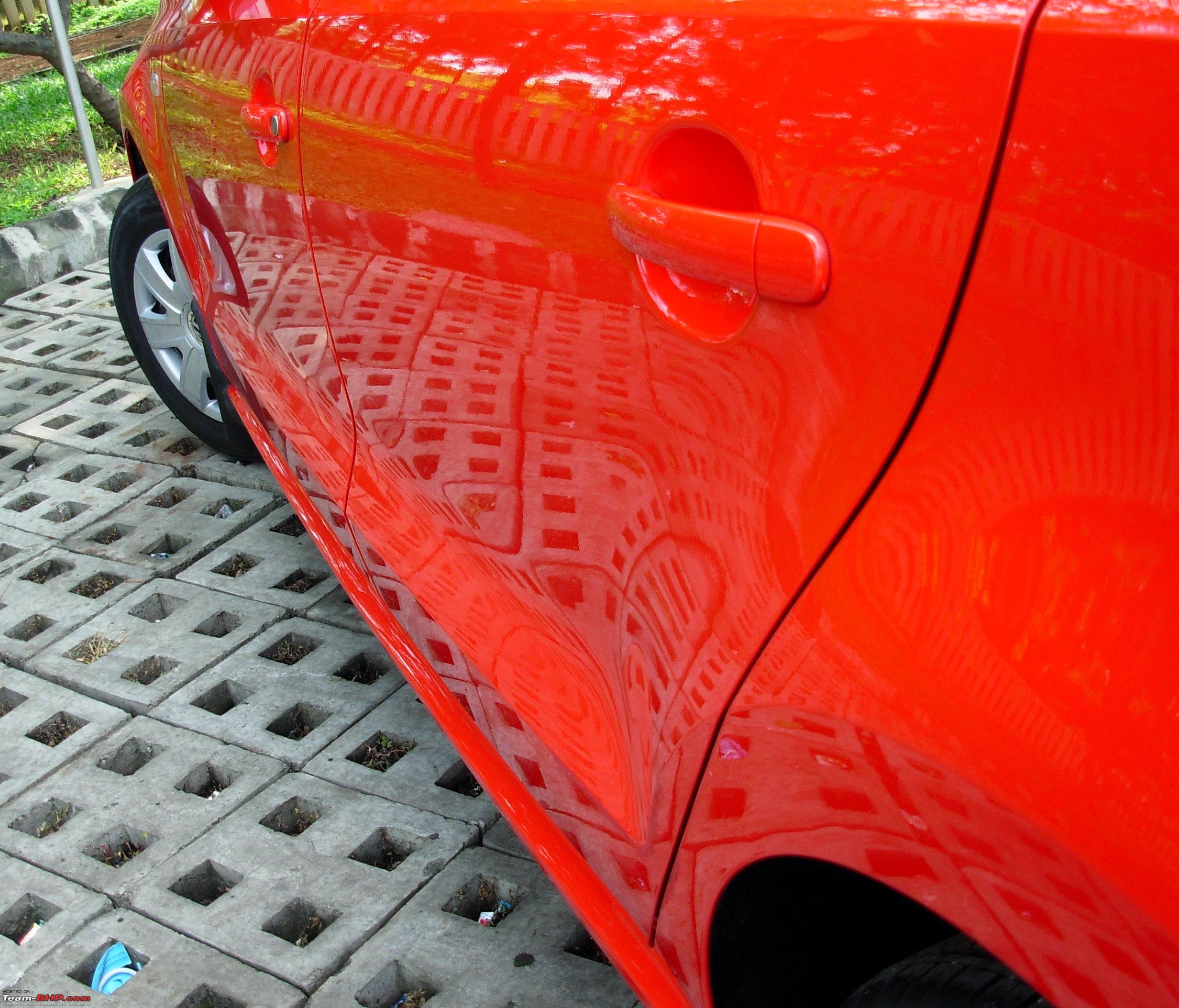

Some snaps post collinite 845.
Hope this stays on for at least the next 3months.

@AvonA7, your car looks asbolutely magnificient. Especially the Polo red looks fantabolous with deep wet shine.
Believe me Collinite-845 will stay for next 3 months or may be more.
I covered my car with one layer 3 months ago, have seen my car through Pune rains and Sun and still could see great beading in yesterdays heavy rain.
RemingtonSteele is offline

Stunning job on the Polo. As long as you don't use a wax stripping car shampoo, the 845 should last you a while.

Amazing shine on the polo. IT seems quite happy-- smiling face. I think that the layer of these waxes on the car's bonnet require reapplication frequently after some time as compared to the other parts of the car, which must be due to the heat generated by the engine. At least in my case it does.
Collinite users do share your thoughts on it.
