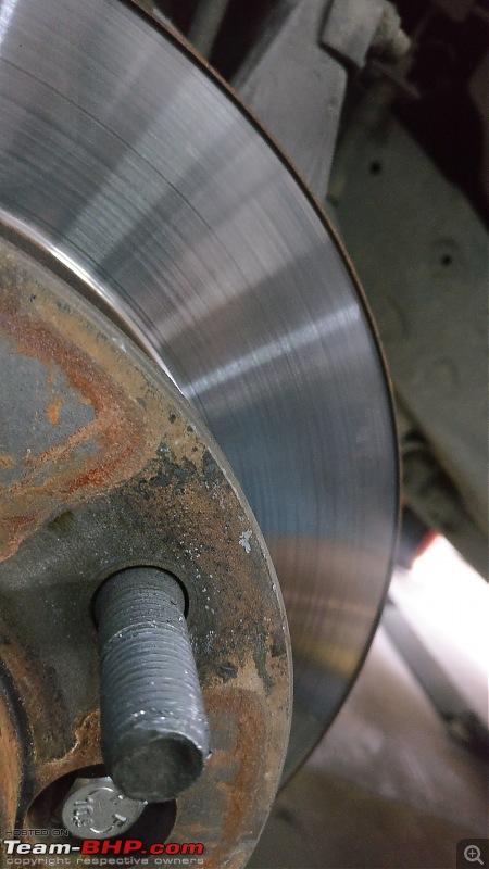

My Storme is in TASS for the 4th year service and I was informed by the SA that the front discs need replacement, as the thickness of the discs is quite low. The brake pads however have good life left in them.
While I couldn't find any tell tale signs or abnormal scratches on the disc (it feels smooth on the surface too), SA is suggesting that since the thickness has reduced, the lip portion (highlighted in pic below) is more pronounced/projected now; he's giving it max 3K kms of more life left in the discs. Interestingly, the rear discs don't seem to have this kind of setup.
I am not able to buy the logic for few reasons -
1. The car is in its 4th year and has not even completed 50K (its at 491xx still). One set of pads were changed in 2nd year.
2. I have not heard any abnormal squealing sounds and the braking never felt like it was missing any bite.
3. Saw some videos on youtube; the lip and its projection is at about .5 to 1mm anyway, from the disc. Question is by how much should this lip project and is it a right measure to identify a worn disc?
I've asked them to leave the discs alone for now as I wasnt convinced; what do you guys think!?

This is a known TASS scam. They love to ask you to change all discs and brake pads, it brings them easy money. When I owned Tata vehicles, they used to try this stunt with me, I never fell for it and had no problems with the brakes throughout my ownership period.
On the other front, injectors will knock in older cars, especially the ones in which diesel additives have been added. These additives work like detergents and wash off carbon build up which were acting like seals. Without these carbon seals, the worn out heads and linings will leak leading to lower performance, knocking and poor fuel economy.
