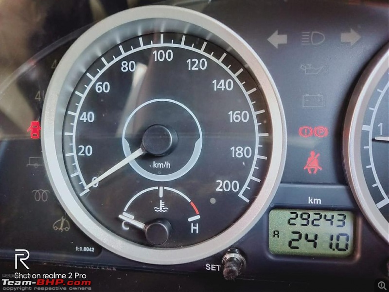

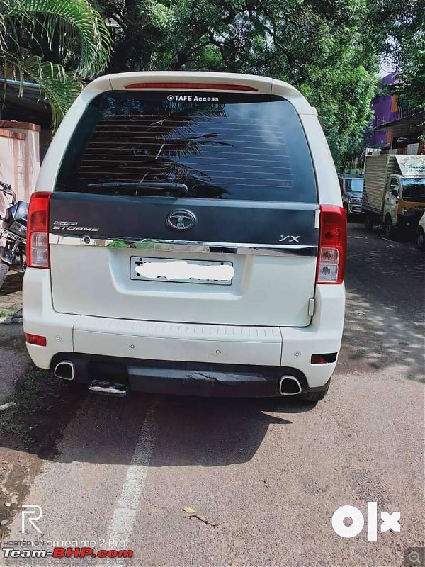

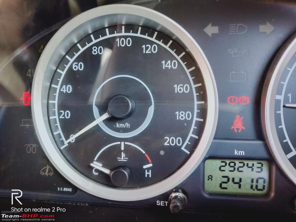

If I had to sell my 3 year old 2018 Storme V400 which has just run 26k km, I would get a maximum of 9 lakhs as resale. And I bought it for 17 lakhs!
Prasanna - i was actually planning to ask you that question. Was checking a March 2018 Tata Safari Storme in OLX https://www.olx.in/item/tata-safari-...iid-1618174585 and while chatting with the dealer i went through Team BHP and found you have a similar aged/specd storme. Was thought of asking you what would be the ball park figure for such a car and now got your answer !! Thanks !!

I have a few red flags
1. The car has a bull bar, and I guess it was used by some one in politics, which isn't a bad thing in itself, except that they drive a lot and the car is always driven by the driver.
2. Not many buy a storme and drive just 30k km in 3 years unless they have multiple cars (in my case I have 3 other cars and hence storme wasn't used much).
We don't really know if the owner had other cars at his disposal as the ad has been posted by a used car dealer.
3. Used car dealers, in most cases, tamper the odo. So you never know if it has actually run just 30k km or more. Tire wear can be an indicator, but SUV tyres last really long (>80k km).
If that car has been driven by one owner and the odo is legit, and if it is in immaculate condition, 10 lakhs is a good price.
9 lakhs would be a steal- its a Varicor 400(better torque than even the new safari) and it is the last gen safari, which is the best safari ever sold(not including the Gravitas here)!
