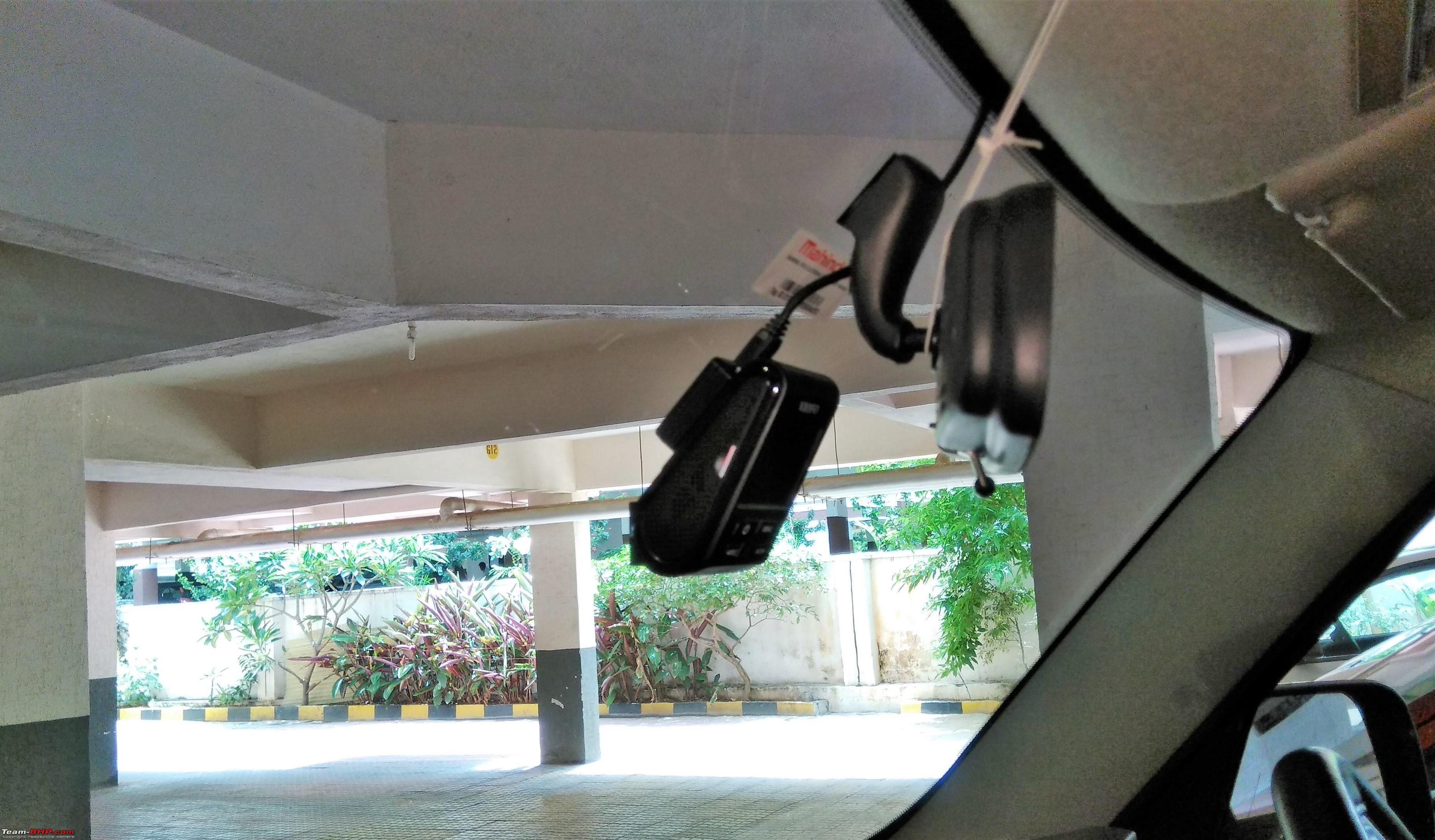

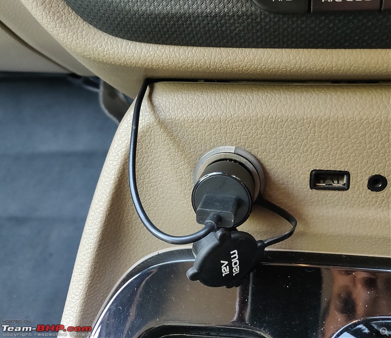

Just got dash cam installed in my Tank. 70mai brand, costed around 4,000 bucks on amazon and additional 450 for memory card. Videos and pictures look a bit oversaturated, but gets the job done.
It supports 64GB card, but installed 32GB card. Unfortunately it supports only Class 10 cards. I installed class 4 card and it doesn't work
Installation was pretty straight forward. Attached few pictures below.
I have the same camera (70mai) as my rear dash cam with a 32 GB memory card. In front, I have Viofo A119 with a 64 GB memory card. Power adapter came with Viofo A119 has got two USB ports and both the cameras are drawing power from the same adapter.
Is this the model with small display? I first thought of going with display model, then dropped the idea as it may distract me while driving. I then came to know that display can be turned off
Yes, it has a small display and screen can be turned off automatically by setting screensaver time.
