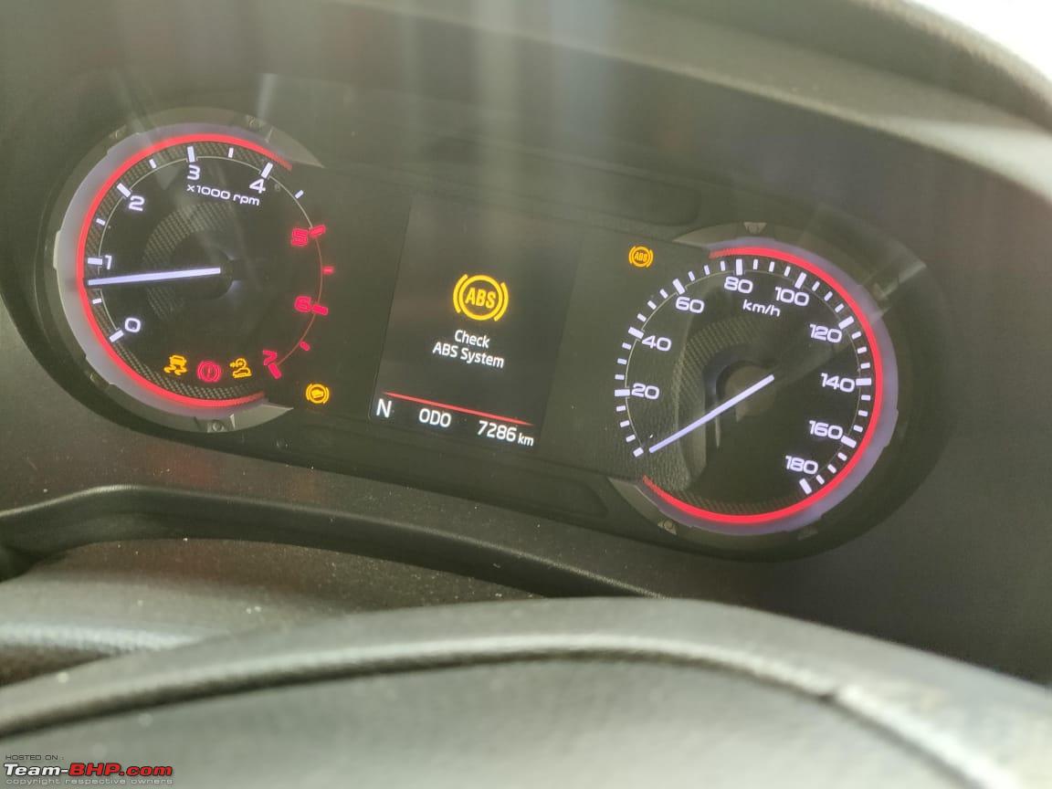

Here is a brief overview of the problems I faced in my Thar after driving it for 41k.
Please know that I am thoroughly impressed and happy with my Thar and have not regretted the decision even once. It shines everywhere, it is a headturner, good off roader and blah blah blah.. we all know the good bits.
However, over here I will be sharing the negatives only that I faced for soft top convertible-
1. It gets dirty. Due to small air vents/gaps here and there, a convertible will never be as clean as a hard top. Some dirt will definitely settle everywhere inside the car. You have to spend sometime cleaning it almost every alternate day.
2.Reversing the car will always be an issue until you get a camera. You can get the camera installed from third party, but will have to go to Mahindra Service Centre to get the Software tweaked without which video will not be displayed on screen of the Entertainment Unit.
3. Within first few thousand kms (November 2020- February 2021), I started facing issues with horn. Its a dual horn. Sometimes it works fine, randomly it starts sounding strange, sometimes it produces only a shrill tone while other times it produces a very heavy tone, sometimes its just like a scooty's horn. This issue automatically disappeared as summers came. Now since November 2021 I am again facing horn issues. In December 21 I visited Munsiyari (good snow). Over there the horn really went bad. It just stopped working. As soon as I came to plain areas, it was better but again. Once or twice each drive the horn goes crazy. Anyways the service center guys believed my horn issue only when I showed them multiple videos of horn going bonkers. They changed it under warranty in Jan 2022.
4. When I completed around 2000 kms, the AC vent direction knob just broke without any rhyme or reason. It still remains broken. Cheap quality plastics I guess. Anyways I have got it changed from after market ones as the service center could not arrange a replacement even after an year.
5. After around 7000kms I faced ABS sensor issues. It used to give warning 'Check ABS System'. Service center got it rectified, though it took a few days for the sensor replacement to come.
6. I rarely engage 4x4. Even during light snow drives, I found 4x2 was doing a good job in this car. However when I do engage them, I feel that a little more than required noise comes from front two tyre areas. However service centre assures that its normal. This noise is noticeable only with top down or if you are outside the vehicle.
7.Within one month of ownership the 12v socket fuse was blown, it was promptly changed by service centre.
8. Around 30k kms later the FM radio/antennae developed a strange problem. It wont recieve any signal. I cannot listen to radio in Thar. I visited service centre before Diwali 2021 for this issue and I was informed that there was some earthing issue. Problem remained. Again visited during December 2021, and I was told that some kind of wiring was required for antenna then I got a call from service center in January 2022 to bring my car for the radio issue. took my car but the problem could not be rectified. even in March 2022, I cannot listen to radio.
9. Seat belt- I faced a strange issue of seat belt jamming, so much so that it would just freeze/lock at any random time. I took it to service center, they didnt really do any thing just pulled it real hard, and I havent had that issue since 10k kms now.
10. Major issue- some random times (thrice till now, in past 2000 kms) the car and the ignition remains on even after you take out the keys. This is a major problem I faced. I take out the keys, still the vehicle remains on, music system, lights everythin remains on, you can even drive. I switch off the engine by putting it in 6th gear and releasing the cluthch pedal while at halt, however everything else remains on. The Only option is to remove the negative terminal from battery. absolutely nothing else can be done. This issue comes up randomly. Service Center has one reply, 'bring it in'. They put their laptop, see the error, remove it and then say that it wont happen again. And it happens again. The problem is that I can't leave the car with every light glowing throughout the night. Not only will it drain the battery, but every thief will know that something is wrong with the car.
11. Its like owning an elephant. You have to give it a lot of maintenance. It needs one service center visit, every alternate month.
Anyways, these were the issues I face(d) with the car. All that being said, I am still impressed by the capabilities of this car. and would love to buy it again.

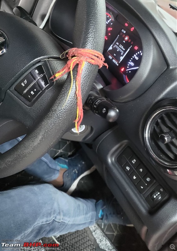

May I know what this small switch is for?
Mahindra Thar : Official Review-whatsapp-image-20220301-9.51.40-am.jpeg

So I got my Thar back yesterday. The small switch is for the lights in AC vents (Mercedes style AC vents). They can be operated by remote, by your phone as well but it also comes with a small switch so i got the switch installed. Why to waste it?
Now the issue of car not switching off and the engine immobiliser being triggered.
Probelm recap- thrice in past one and and half month it happened that when I used to take out the key, the car kept on running along with all lights and everything. The only solution was to disconnect negative terminal from battery. However the third time, just a few days ago when this happened, engine immobiliser got triggered and the car had to be towed to the service center.
Solution- i did not have RSA so called Mahindra customer care. Honestly, the customer care was genuinely very helpful. Immediately they sent 2 technicians from a nearby service center, who put in their laptop and tried and tried but the car refused to start. After their diagnosis they cocluded that Probably some wire was bitten by Rats. And the wiring needs to be changed. Hearing this i got worried and called the srvice center where i usually give my car for servicing and they sent a recovery vehicle and towed my car. They also diagnosed and diagnosed. First they blamed the new AC vent lights, stating that the wiring was probably disturbed. But when I gave proof that this issue had cropped up before the new AC vents were installed they said that it was some lose connection.
Then yesterday when I collected my car I got a new explanation that the amplifier/music system was getting electricity from some port which caused backflow of electric current and they have rectified it. Frankly I do not buy it as My Amplifier is connected via separate connection directly with battery and anyways not much clarity was given to me. Anyways no explanation as to why the immobiliser was triggered.
The car is working fine now. In case this happens again i will just take the keys out and hope that the battery doesn't die. I have now purchased the 70mai jump starter for those extreme cases where battery dies. I dont want to take the risk of disconnecting negative terminal and getting immobiliser triggered.
So thats it.
Be that as it may, I can assure that at least in Lucknow the Mahindra customer care tries really hard to ensure help reaches you asap and the service center guys genuinely try to help you. I am happy with the services.
