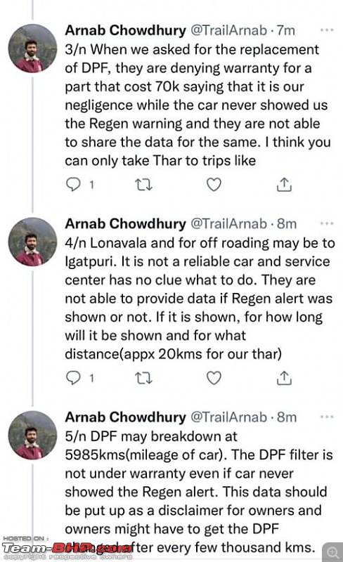

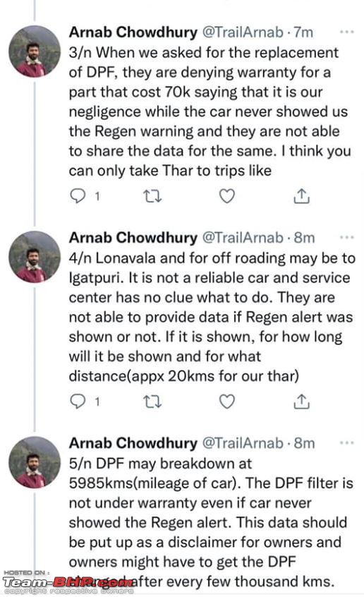

Came across this Facebook post where a Thar broke down in the hills of Spiti due to DPF regeneration issues. Other concern in Mahindra refusing warranty replacement on the DPF filter stating driver negligence. If the expectation is that one will drive at 60-70 kmph for 30 min in the hills for DPF regeneration then
Mahindra Thar : Official Review-dpf.jpg
Source - https://www.facebook.com/groups/rush...42482/?app=fbl
What does this mean to the guy who is driving the Thar in the hills of south India, say Ooty or Chikkamagaluru? After an hour of relatively slow driving around the ghats or their estate, is one expected to drive spiritedly OR keep revs greater than 2K RPM for longer time duration in order to keep the DPF filter clean?
There is an option for manual regeneration. Here is the youtube link
In this Thar, the customer is claiming that he didn't receive the regen notification. Does anyone know if Thar has a fail safe mechanism which takes care of situations where regen is not done in time.

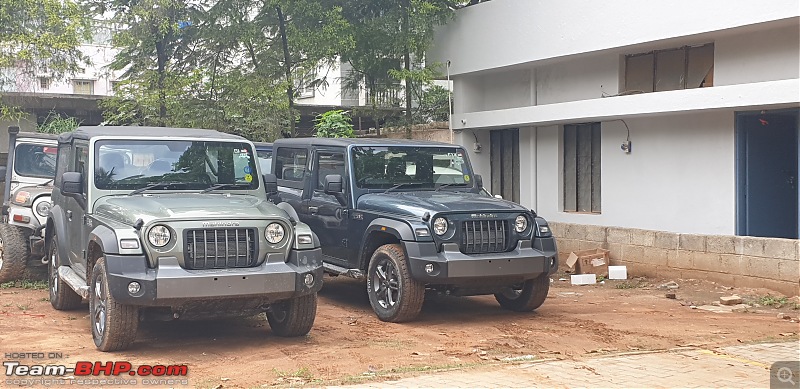

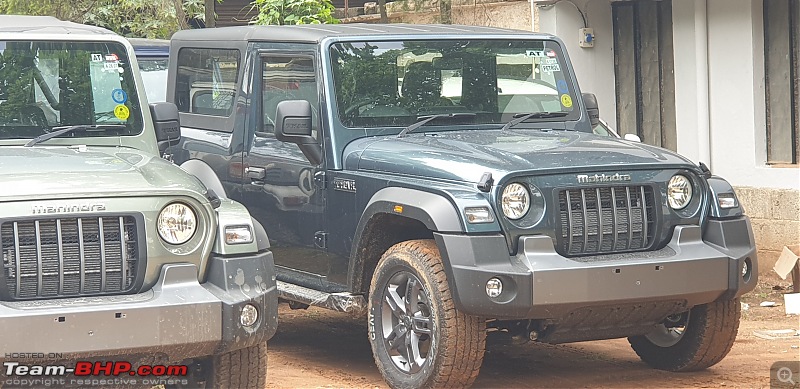

I also got a chance to have a close look at the Aquamarine colour which I booked. Few pictures alongside the Rocky Beige. Both cars were dusty and hence the colour won't be as same as in the photograph. Also got to access the dealer yard. Most Thars parked were petrol models and many of them were found to be without the head units. The dealer folk who accompanied me mentioned most cars would get delivered in next few days and deliveries are moving at snail's pace owing to inauspicious month as customers plan to have the car only by next month. He said they've received head units for all the Thars in their present inventory.
They've also received the XUV700 TD vehicles too, four of them. The new vibrant blue(not sure on the Mahindra lingo for this) and there was one BMW ish blue too which appears black from few feet away and once you're near the car it would appear dark blue. Photographs were not permitted. TD's would start post October 2nd.

[quote=Tourer;5158275]There is an option for manual regeneration. Here is the youtube link
Though the youtube video shows a manual Thar, the owner's manual does not mention the Park Regenration process to be manual or automatic specific. The process listed on the manual is as follows;
"DPF park regeneration is only possible when the REGEN telltale is ON in the instrument cluster
• Park the vehicle safely in a well ventilated levelled open space and free of any flammable material.
• Shift the gear lever to Neutral with the engine running and apply the parking brake.
• REGEN screen will appear in the drive info menu of instrument cluster when the REGEN telltale is ON
• REGEN screen will go OFF if REGEN telltale turns OFF.
• When in the REGEN screen of the drive info menu, long Press OK button to start park regeneration.
• Once regeneration starts, “In Progress” text will appear below REGEN. The engine idle speed will increase indicating regeneration has started..
• Park Regeneration can take up to 30 minutes to complete. Once completed the REGEN warning lamp in the instrument cluster will turn OFF. The engine’s idling speed also returns to normal"
REGEN option on the menu will appear only when vehicle is capable of Park regeneration (DPF lamp ON or Blinking) along with REGEN telltale.
Long Press Ok button to start Park regeneration.
I think this process is applicable for both manual and automatic transmission. Anyone one on this forum who has used this process on Manual or AT variant can enlighten other members.
