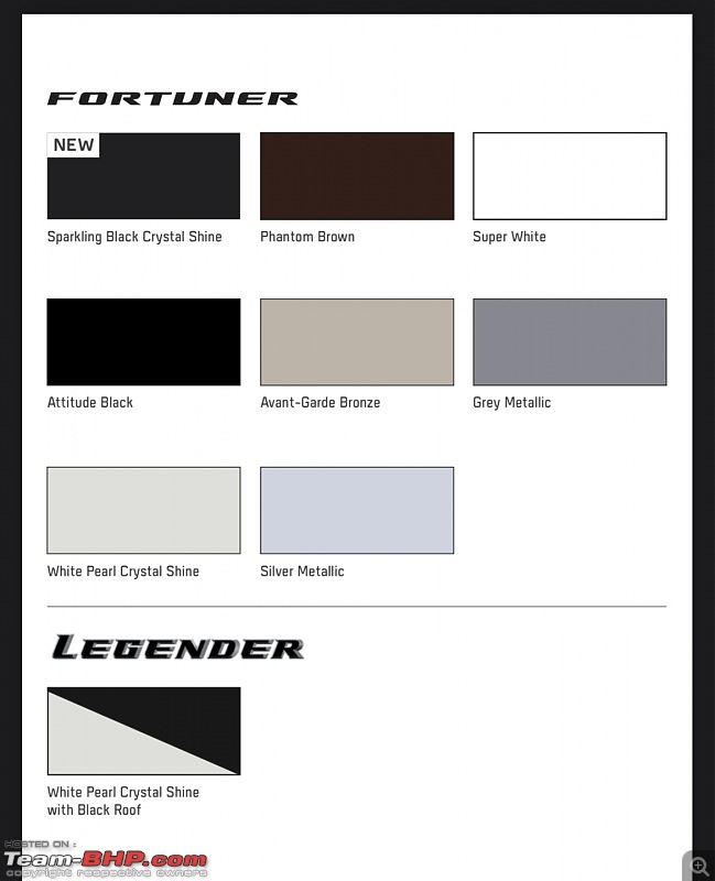

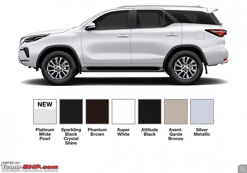

Originally Posted by R_R View Post
There's a new color combination available on the Toyota Fortuner: what was previously offered only on the Legender (the Pearl White with Black roof) is now available as an option on all Fortuner models except the GRS. Costs Rs. 15k extra. The Legender continues with only that one color combination available, while for other models, this combination is only an option, and other colors are available. I learned of this today when I asked my sales guy for a copy of the latest prices, since Toyota had increased prices a few days ago, and saw this option listed. I am assuming this came from Toyota itself, and this is not a gimmick by the dealer.
Can’t find the new colour combination on Toyota’s website, so it must be a dealer option.
Meanwhile what I see is a new colour Platinum White Pearl (from the Camry) which replaces the White Pearl Crystal Shine (or can it be the same colour with it’s name changed?)
Old Brochure which hasn’t been updated:

New colour shown in the colours tab on the website (Grey Metallic is no longer available?):
2021 Toyota Fortuner Legender & Facelift Review-3a7c12f43eda4f08bc389449c3da1c8f.jpeg
