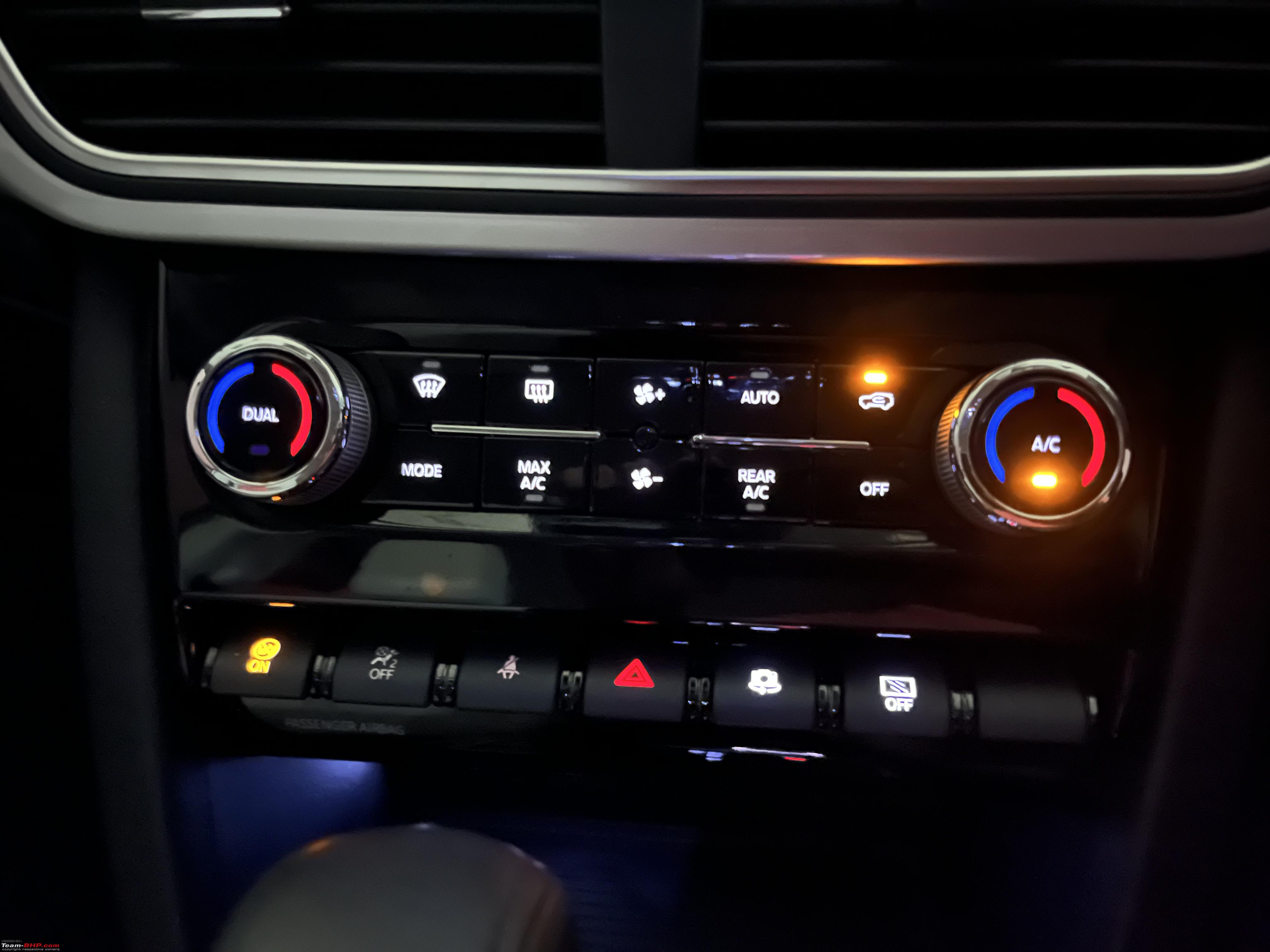

Thanks for detailing out the functionality and dependencies involved.
I think the problem statement is correct i.e turning on the ‘Auto’ mode turns Recirculation off unless the temperature is set to lowest.
Below are the screenshots-
1. Default Recirculation on -
2. AC is turned on-
3. Auto is turned on leading to Recirculation getting off
4. Recirculation is again turned on leading to Auto getting off
5. Both Auto and Recirculation are on when temperature is set to lowest

I think the problem statement is correct i.e turning on the ‘Auto’ mode turns Recirculation off unless the temperature is set to lowest..
What is the outside temperature at that time? If its well below the set temperature then Auto mode will start with recirculation off and draw air from outside to remove the moisture inside the vehicle. This is how it should work for all vehicles in cold weather, especially in single digits.
Absolutely correct. Whenever the temperature is low or its foggy, I have seen even if the mode is Auto, it takes outside air by putting recirculation off. Initially I thought it's a problem and visited service centre for this. The service centre honestly was not aware of this and checked the A/C thoroughly , but could not identify any problem. I slowly understood it after observing the behaviour of the recirculation based on weather conditions.
Absolutely, outside temperature is quite cold, mostly around 10 degrees and haven’t been more than 13-14 degrees during this observation period.
However, both Auto and Recirculation are enabled if the temperature is set to lowest (18 degrees i guess). Not sure what explains that.

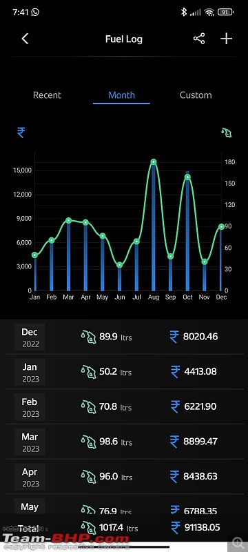

1. Fuel log keeps data for only 1 year after the last update. One bug I found here is that the Monthly log view totals up the fuel filled for the past year too. For eg: January data will be of Jan'23+Jan 24. (Dec'22 Fuel qty in the picture is total refuel for Dec'22 & Dec'23 combined)
If it’s well below the set temperature then Auto mode will start with recirculation off and draw air from outside to remove the moisture inside the vehicle. This is how it should work for all vehicles in cold weather, especially in single digits.
I got some time to explore it a bit today. The temperature at which it switches to recirculation or upper vent only vs upper and foot vent is dependent on ambient temperature. With an ambient temperature of 31C, it switches to both vents at 31.5 and switches off recirculation at HI/32.5. Earlier today, when the ambient temperature was lower, they were happening earlier. Looks like the switches are happening when it crosses ambient temperature and X degrees around ambient temperature respectively. I guess that explains why you get recirculation ON at LO only; LO and HI are treated as extreme ends.
