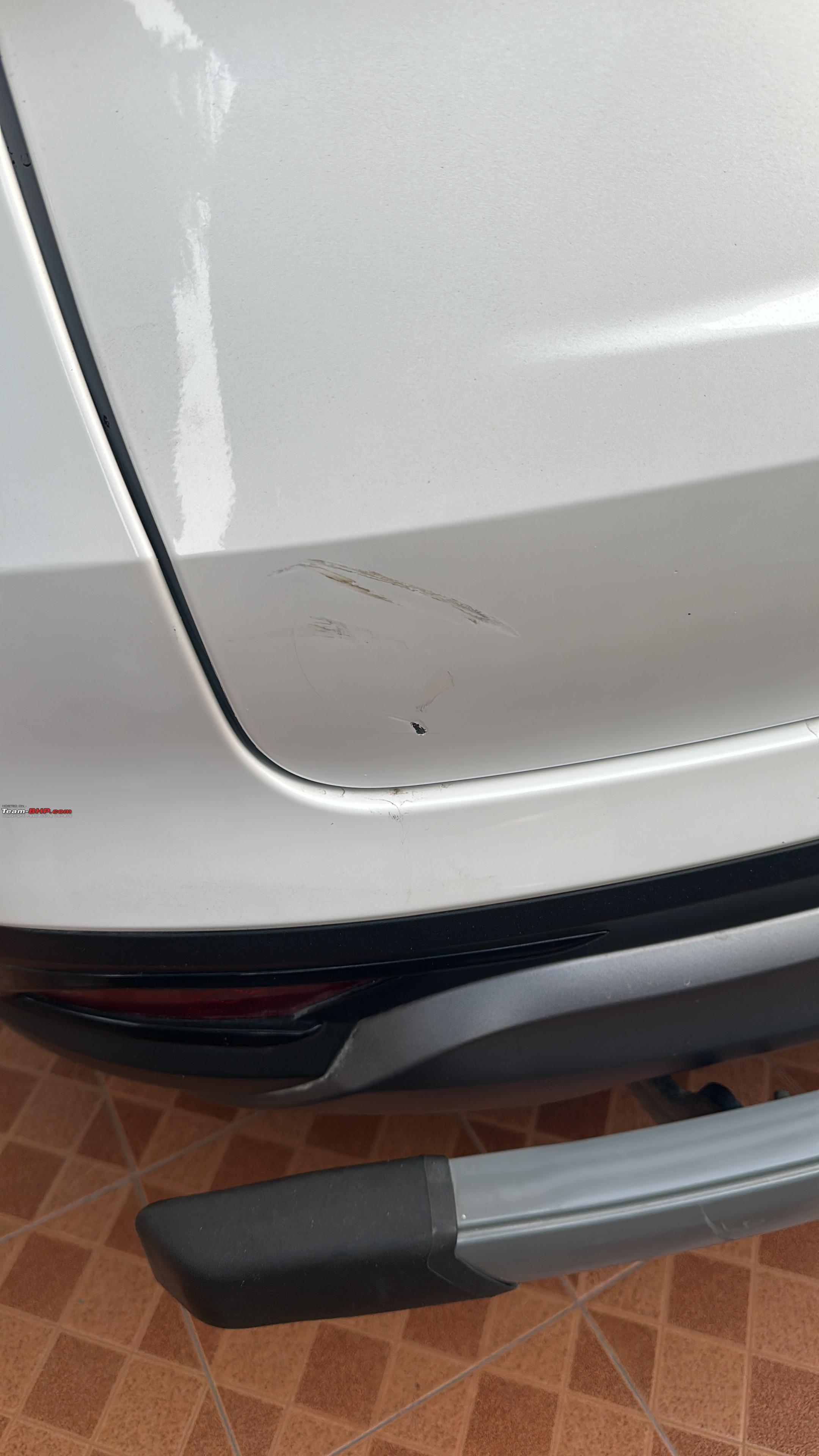

Hey Folks, had a bit of a crap luck on a monday morning while driving to office. In extremely slow driving conditions a tractor trolley hit me from behind when I slowed down cause of traffic in front. There was also a AEB warning along with my braking but speed was anyways <20kmph. need to see read cam footage but tractor couldnt brake and I felt a decent impact. Upon inspection the damage looked fairly low vs my worst case expectations.
Traffic police showed up and tractor guy knowing his mistake was being apologetic. After some discussion I let it be since there was no point trying to extract money from the poor fellow. However he was driving tractor with LMV license and I am sure traffic cops gave him some grief. I took pictures and left the spot. On reaching office I completely opened the tail gate and then saw the real damage. Initially I thought maybe plastic tail gate was the reason there was no damage but I was wrong.
Damage from outside. Logo damaged and some reflector housing broken in bumper.
On completely raising the tailgate is saw extent of damage
Will have to go to body shop now i guess. My entire ownership of XUV500 never had a body shop visit and this one will see within first 3months :(
