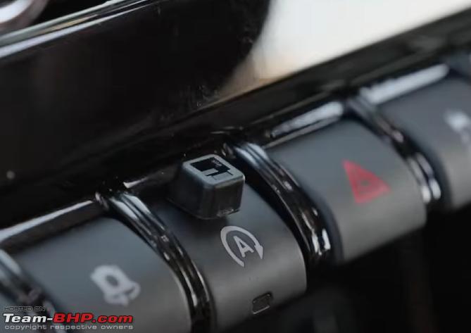

Re: Mahindra XUV700 Review
Originally Posted by OrthodocX View Post
I agree about the poor implementation. It should wait at least for a few more seconds after a complete stop before triggering, but alas, the Mahindra Gods felt otherwise when bestowing us with this "gift". Unfortunately my helpfulness meets a wall here and i don't know how one can solve this.
I am thinking of creating a contraption where the auto-start stop button is always pressed in.
Apparently this is working for the ScorpioN / maybe Thar 3 door too
Watch from 5:57 mark
coin
Name:  autostartstop stop v2.png
zip-tie
Name:  autostartstop stop v1.png
Wow! This looks promising. I'd be so happy if this works. I'm just curious if it will have any detrimental effect on the button or any other glitch in the software due to constant feedback from the button. Coz it's not a on-off "click" type switch, it's just a toggle button. But I am willing to try it out and see what happens.
What kind of contraption do you have in mind, given that a coin or a zip tie allegedly works well? I'm genuinely curious about this and thank you from the bottom of my heart. This auto start-stop is the biggest irritation I have with this car
OrthodocX is offline   (1) Thanks

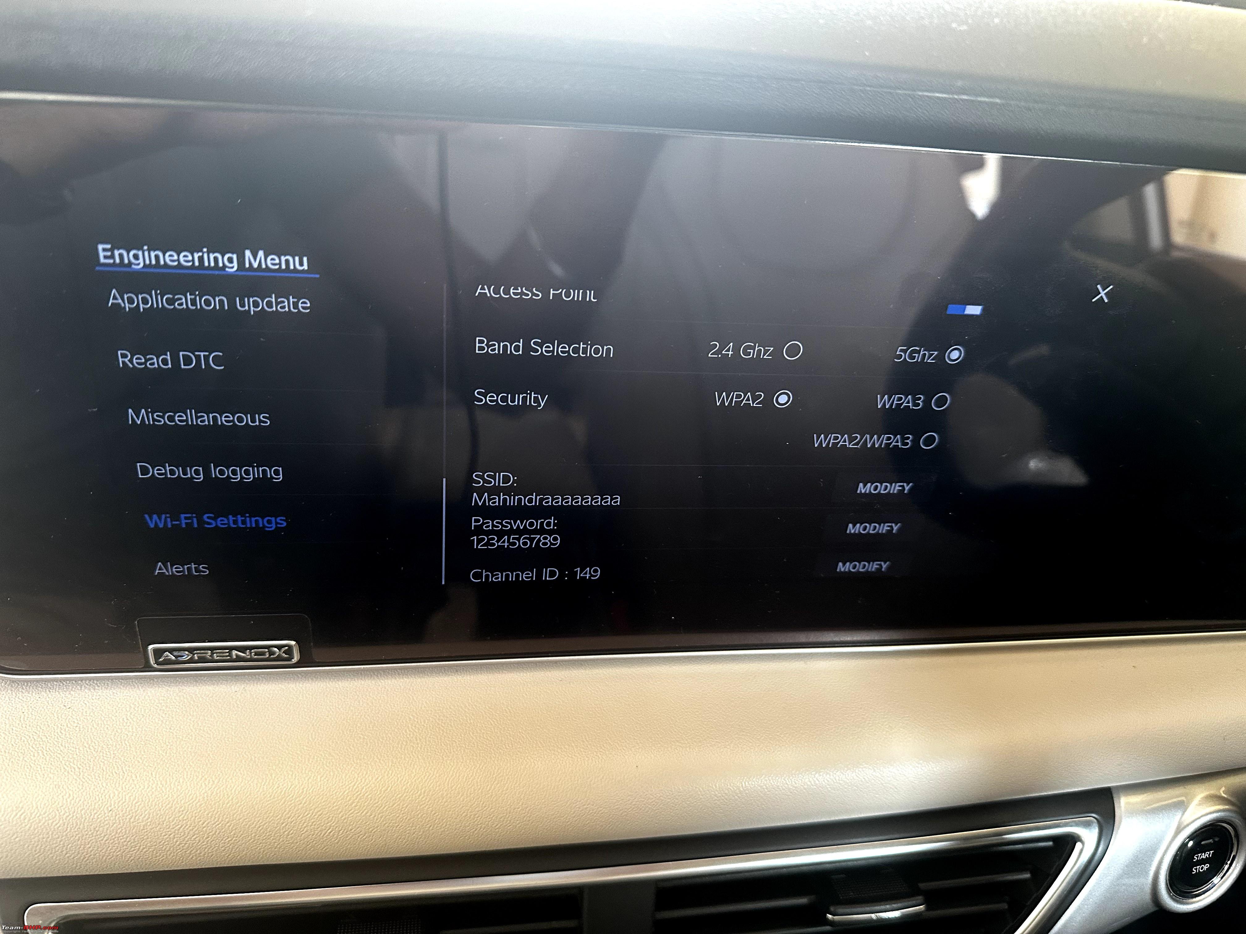

To everyone still struggling with Apple CarPlay not connecting or frequently disconnecting, even two years after its launch, here’s something that might help.
After six months of trial-and-error, I found a solution that has been working perfectly for me for the past month.
First, access the hidden Developer Menu by pressing the Settings icon five times on your XUV 700’s infotainment system. Then, go to Wi-Fi settings (second last option) and change the Access Point Security to WPA2 and the Channel ID to 149. After that, delete the pairing from both your phone and the infotainment system. Reconnect your phone as a fresh device, and it should work smoothly.
The only minor issue is that sometimes CarPlay doesn’t connect automatically. In such cases, I simply open Bluetooth and press Phone, Music, and Apple CarPlay in sequence, and it connects immediately.
I’ve visited three service centers, and no one was able to fix this issue. Even the Cotek team had no idea how to solve it. Hopefully, this method works for you too. For reference, I’ve attached a photo of the settings.
