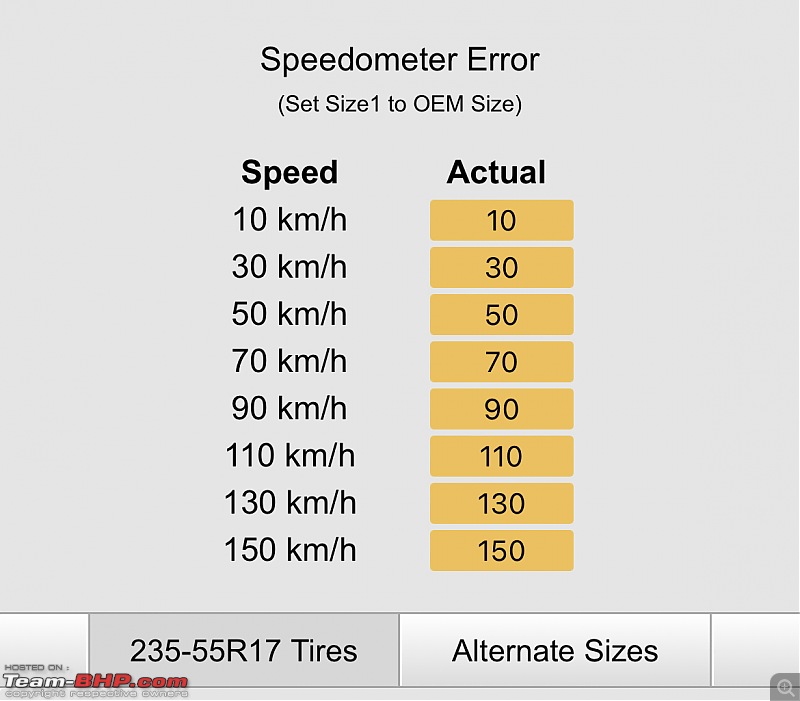

Re: Toyota Innova Hycross Review
Originally Posted by car_crazy1400 View Post
It is a Hybrid only.
I also have upgraded tires to 235/55R17, Michelins Primacy 4 since the car had done 400 odd kms.
There you go! You have upsized the dia by close to 5%, which is why the displayed values will be less than the true value. System is under-reading.
Compared to the 215/60/R17 that the VX and VX(O) get from the factory, the 235/55/R17 is an upsize one can do that is as close to factory spec as it can get !
Oh it is R17 on the VX! My bad. I assumed 235/55 on the 18 inchers of ZX.
There you go! You have upsized the dia by close to 5%, which is why the displayed values will be less than the true value. .
Actually it is less than even 1%.
Attaching screenshot for reference.
Even though it's close to factory in terms of radius and circumference,
It's way off when it comes to matching the rim width with tyre width.
Refer the below chart.
I'm assuming that the rim width of hycross variant with a tyre size of 215/60 R17 is 6.5. Correct me, if I'm wrong. If the above assumption is correct, for 60 profile tyres, the ideal tyre width is 215/225 mm.
In case the profile is 55, then the width should be even lower at 205 mm. In this case, the width chosen has gone in the completely opposite direction. So, without a change in alloy wheel width to 7.5 inches, 235/55 R17 is a wrong upsize.
Reference link
Now, even if someone decides to upgrade their alloys from 6.5 inches to 7.5 inches, it might still not be a rosy thing to have. This change will increase the weight of tyre + alloys by around 15 percent. The problem with that increase is that tyres and alloys contribute to the unsprung weight of the vehicle. The lower the unsprung weight, the better it is for road grip especially when driven through uneven surfaces at a speed. Now, what's acceptable unsprung weight differs with different car models.
But when you choose the stock tyre size, atleast you can be sure that world class engineers in the OEM manufacturer's R&D has tested all these variables extensively and they'll atleast make sure that the combination of rim radius, rim width, tyre width, tyre profile, tyre load and speed rating, side wall strength is of acceptable safety and robustness in the diverse conditions that the vehicle has to take.
And hycross has a wide range of stock tyre choices in 225/50 R18, 215/60 R17 and 205/65 R16. I'll highly recommend hycross owners to stick to one of the above choices. My personal favourite in that list is 205/65 R16 for its comfort and abuse friendliness.
PS: I do not own a hycross. I own an Innova Crysta 2.8 touring sport BS4 diesel automatic. I've downsized my tyres from 215/55 R17 on stock 6.5J alloys to 205/65 R16 on stock 6 J alloys. I feel this is the best investment I've done on my Crysta till date. In addition to the tyres being comfortable and abuse friendly as expected, I'm also pleasantly surprised by the traction and braking both of which feel surprisingly better on the thinner high profile tyres! I'm not sure if the switch to continental UC6 has anything to do with it. But, I'm just enjoying this downsize.
