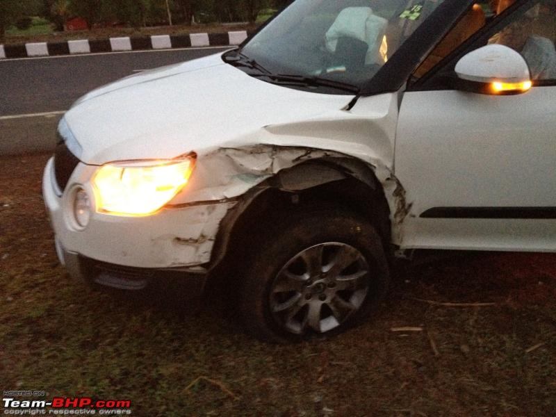

Kindly look at these pictures of the Skoda Yeti of one of our fellow BHPians and compare the impact with that of the XUV in question:
Link to post: http://www.team-bhp.com/forum/test-d...ml#post2798559
Now, I really don't want anyone to come up and say that airbags weren't needed in the Yeti's accident and it's a waste of money.
Or
Yeti has everything fine but the hit was solely at the airbag trigger point.
Well, how I see things is:
"An expensive car is expensive because fewer corners cut"
Maybe Mahindra saved costs by using lesser number of sensors or poor quality sensors or whatever.
Components like airbags should be over-engineered and over-engineering means they should work 999 times if the vehicle collides 999 different ways and there are 999 chances of death or grievous injury.

Arvind has given his money to Mahindra for additional protection and Mahindra has failed to deliver that when they were actually supposed to. Where is the scope of questions in this?
Look at the pictures of the Yeti in my previous post and look at the pictures of Arvind's car, the one on Team-BHP home page and the previous case of black XUV that aquaplaned and overturned - I SEE A HUGE DIFFERENCE, if you can't see then I can't help.
