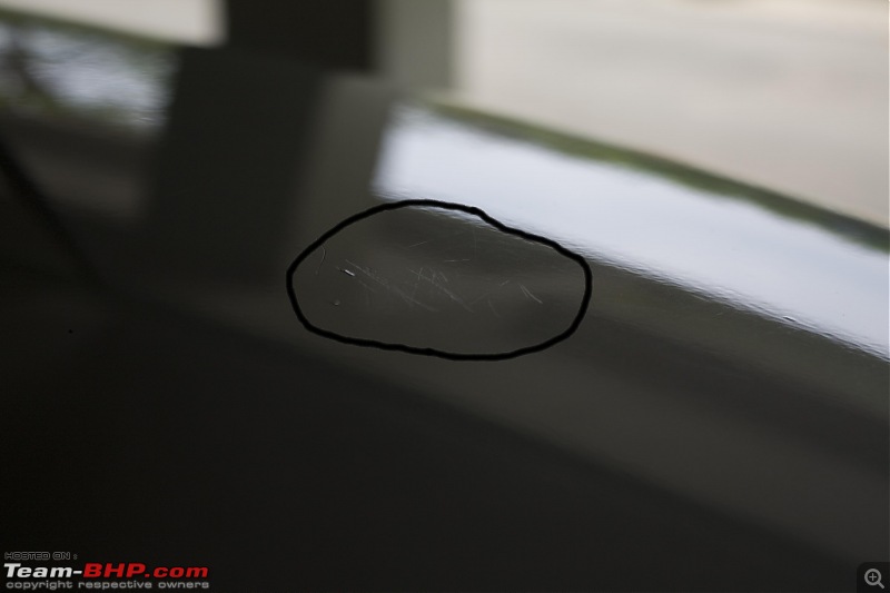

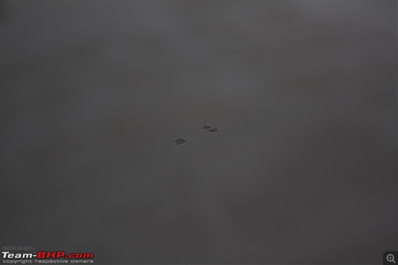

In addition to above, here are a couple of problems with my 11 year old car.
1. At some places on the roof, there are small spots where the pain has just vanished. Here are a couple of pics of such occurrences:
2. There are some light scratches, again on the roof:
3. And then there is this long somewhat deep scratch along the driver side door.
Will using Meg's Ultimate Compound followed by SwirlX and then Polish help get rid of these?
If not, then what else? Paint tubes?
Thanks!
Amitoj
My reply in bold.
(gurus, please correct me if I'm wrong here. Thanks)
The process you mentioned works on light and not-so-deep scratches. If the scratches are deep, you should first fill up that scratch using a small paint brush and then try to correct it. I tried quixx scratch remover(which apparently is the best) on a few scratches, it managed to lighten deep scratches, but removed the light scratches! My car gets vandalized a lot when parked in college .
