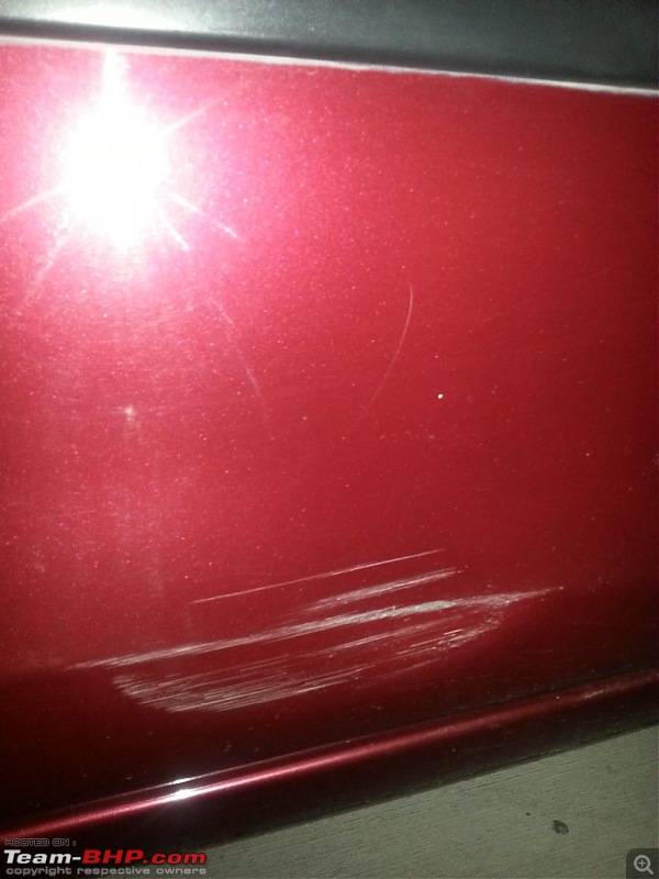

Damaged my car while reversing yesterday. There was a big screw that was protruding from the telephone pole and it ripped away the rear bumper. The pic below might give a better idea:
Maruti Ritz : Test Drive & Review-20140506_124039.jpg
An year back the driver side door was damaged. There was a minor dent too on that area:
Maruti Ritz : Test Drive & Review-20140506_124051.jpg
I was holding off the repair on the door so that I could club the repair with any other major repair work. Now it's time to get both the rear bumper and the door fixed.
Folks, please recommend:
1) Is it better to get both the damages fixed by MASS using insurance? I called the insurance guy of RNS Motors. According to him, door repainting will cost around 7.5k, and insurance might pay up to 5k.
For rear bumper, total cost would bea round 7.5k. He told that the insurance company might pay just 2-3k since it is plastic/fiber part.
2) Is it better to get it fixed outside of MASS? I have read good reviews about Trend Automobiles. Based on your personal experience, can you please recommend any other place where I can get it repaired?
3) I was told that the probability of insurance getting approved for both door work and rear bumper replacement is minimum. There is a high chance of getting insurance approval for rear bumper. Even if I do claim insurance, the premium might increase next year and I might get less amount when trying to sell my car later. So it worth it?
scorpion_blore is offline
I had a similar incident a month ago where a biker rammed into me tearing away my rear bumper.
Went to MASS and asked them for an estimation. The estimation for the new bumper+painting+labour and taxes it came to 7K. But finally I paid 5.5K so I advice you to get a quote from another MASS and also better to get it done there since painting and matching it will be their headache so it'll be done nicely.
OEM Bumper would cost approx 3K. Painting and labour could be 3K.
If money is not an issue then get the parts changed at MASS as an insurance claim is waste.
Anurag
@scorp: Sad to see the damage caused! It should be a straight forward fix though; I'd just be wary of the color matching, be it at MASS or independent garage as there's just no way to know until it's all repaired and repainted. If possible, checkout some repair jobs from both to take a final call. Please do share the cost break-up of the repairs and the option you took; my car is also due for a re-spray (only bumpers) to hide the numerous scratches.
I guess the answer to that question would directly depend on how much of a hit you're ready to take on your pocket for getting the damages fixed if you don't want to claim insurance; increased premium and resale value will just be a consequence of the former. I think both those factors will still be a relatively small hit (probably) as compared to the total repair costs.
