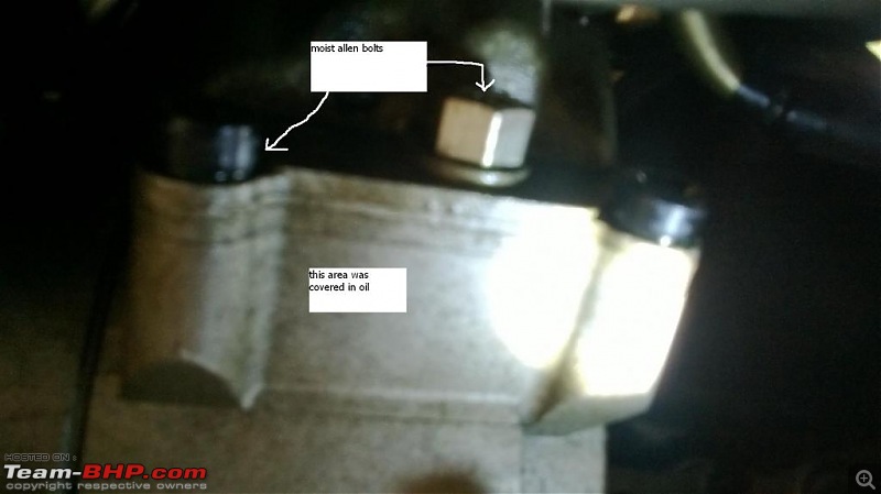

I noticed an oil spot on the floor where my car is always parked. It was just below the front right corner. Upon inspection, I found that a sticky yellowish oil has been leaking around the AC compressor and it was splashed all around the place. Some oil was resting on the mount where two pipes enter the compressor. There are too many pipes around that area. Somehow I wiped the oil with cloth and after an hour I could see some oil coming out around of the allen bolts (there are total 4 of them) which hold the piece of metal where the refrigerant enters and leaves. What could be the oil? Is it some sort of lubricant for the compressor or the refrigerant itself (I doubt because the leakage is of oily substance). The oil is not something similar to the coolant/brake oil or power steering oil. Also the oil was lying on the back cover of the radiator, which means it must have been splashed.
What could be the possible reason? Could it be cracked allen bolts? Leaving for workshop on monday. Any pointers would be highly appreciated.

Originally Posted by Blow Horn Ok View Post
What could be the possible reason? Any pointers would be highly appreciated.
Your a/c refrigerant oil is leeking through the compressor, it could be the compressor seal itself or as simple as pipe joint being loose, worn out o ring. Get it checked by a competent a/c mechanic(would be cheaper than ford service center). In between, do not run the a/c as the compressor might get seized due to less oil. Also make sure its not the power steering oil as PS hose also passes by the compressor, do check the oil level. Going by the colour you mentioned and pictures, its highly likely to be a/c compressor oil.
