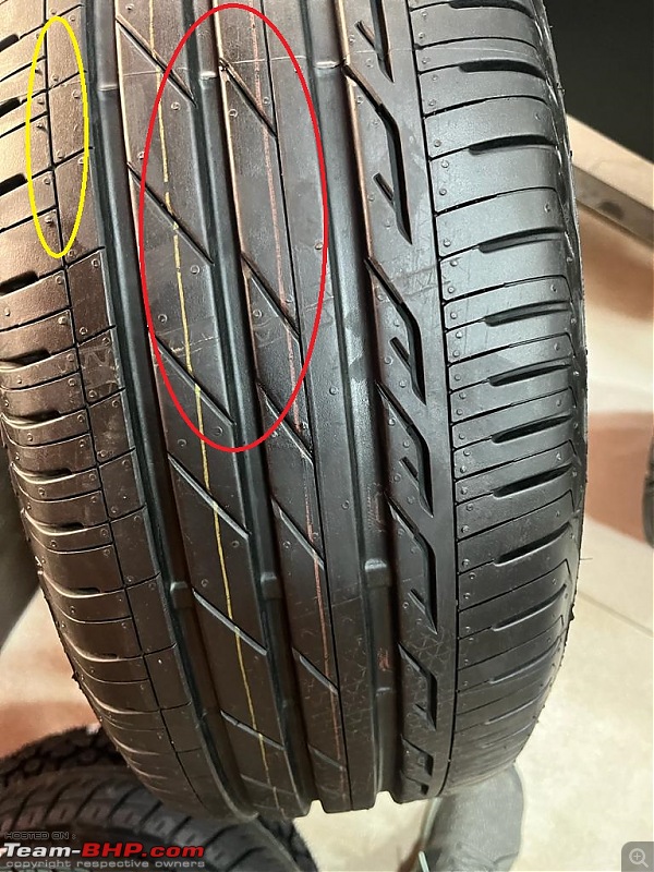

I have replaced all four tyres with Bridgestone Turanza T001 215/55/R17. These are not brand new tyres but have done around 200kms. Manufacturing date is May’22 and paint mark is still visible. Checked bead region to make sure that there is no cut or bend. I paid Rs 7000/ per tyre whereas new tyre price is Rs 11500/.
Just adding on to Manish's post for the benefit of members. The tyres in question were removed from the Innova Crysta, whose higher variants come with 215/55R17, and it is common for a lot of people to go for taller 215/60R17 tyres as a "zero mile upgrade" on the Crysta, as the 215/55 profile is a little less for the Crysta, especially at full load when it can tip the scales at 2.5 tons. However, for the EcoSport it would comfortably serve the purpose, especially in comparison to the stock size of 205/50, which was prone to damage as highlighted earlier.
Another point to be noted is that when the dealer claims that the tyres he is selling have only done so-and-so km, there are a couple of checks that we can do as customers to easily ascertain if they are being truthful. Apart from the basic sanity checks - like manufacturing date, punctures, cuts on the sidewall, etc., one should also look for these markers:-
Ford Ecosport : Tyre & wheel upgrade thread-whatsapp-image-20221027-5.35.35-pm.jpeg
New tyres (usually) come with a mark of paint on the tread region (highlighted with a red circle in the above image), this is used in various stages for traceability and sorting by the company, and also to differentiate between different SKUs for the same size and product (say for instance, MRF supplying 215/60R16 Wanderer Street for both the Kia Sonet and the Maruti Brezza - they would have a different paint mark). This mark would disappear after around 500 km of usage. However, with the advent of RFID and other traceability measures, usage of this system is on the wane, and these days it is increasingly common to see brand new tyres without any paint marks.
Don't fret - there's another identifier (marked with a yellow circle) - the vents (small holes through which excess rubber escapes during the moulding process). These can be small projections (like the first image) or simply circular impressions (like the second image). This is a marker which typically fades after around 1000 km of usage.
Apart from this, the tyres the dealer is selling you should have been demounted with a lot of care and the bead region (highlighted with green lines in the below image) should be free of any bends or cuts.

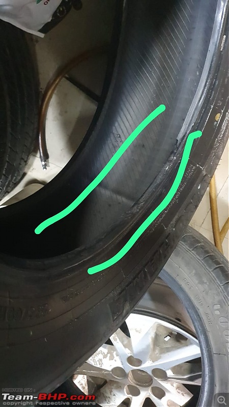

Ford Ecosport : Tyre & wheel upgrade thread-whatsapp-image-20221027-5.44.26-pm.jpeg
Even a minor bend or a small cut in the rubber like in the images below will lead to air leakage, and should be grounds for rejecting the tyre. Even if the dealer offers to use fevi-kwik to fix the cut (like what happened to another BHPian who reached out to me), refuse it by all means.
