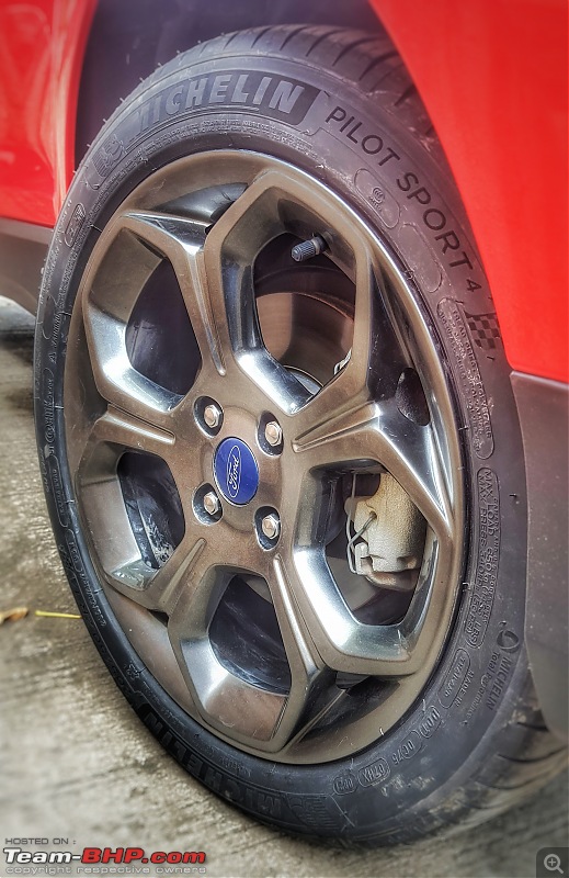

Replaced the stock 17" Bridgestone Ecopia's after 44k km with Michelin Pilot Sport 4 in the same stock size (205/50 R17).
Was looking at 205/55 R17 or 215/55 R17 but did not find any good options available. 225/50 would have been too much for the Ecosport and I was not ok with the compromise in power.
Since I've not had any problems with the Ecopia's, went ahead with the best tyre in stock size. You can't go wrong with the PS4's. Michelin supplies seem to have improved and I got May 2021 tyres at 10k a tyre including fitting.
Immediate feedback is that low speed ride feels the same but there is a big improvement at slightly higher speeds. You can definitely feel the extra cushioning and things like road ruts, ridges do not have the same crashing effect as the Ecopias.
The stock Ecopia's held on pretty well and felt grippy enough too, but had bad cracking, expecially on the outer walls. There was enough thread for another 5-10k km, but the cracking prompted me to get them changed.
