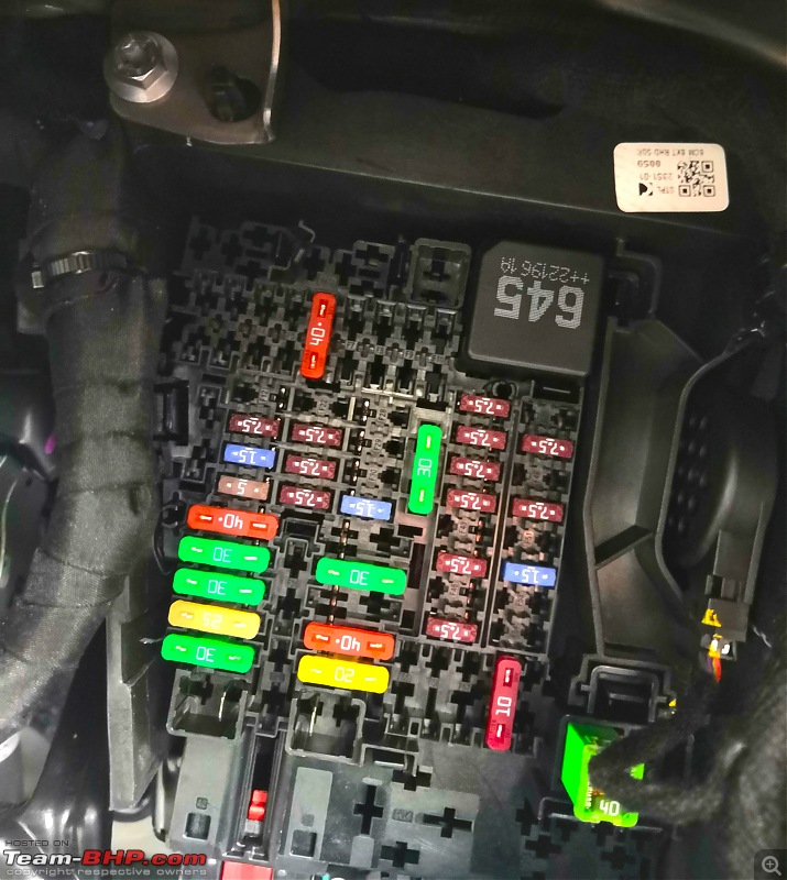

My vehicle is VW Virtus Highline (Manual 1.0)
I am not questioning the reliability of the technology, it's been around for a while, although most of the companies we purchase DVR from are Chinese manufacturers( I am not implying China cannot make quality products, but it depends on their intent and customer requirement). This is evident from some of the half-cooked user interfaces and support apps. So I won't feel surprised about one of these devices malfunctioning. On other hand, modern automobiles rely so much on electrical and electronics and I don't have enough knowledge to meddle with them and feel confident.
Recently I have read so much news about vehicles catching fire etc which was not much heard of in the past. I think the reason is the unprofessional handling of wiring and electronics in the vehicle. In modern vehicles, there is so much which actually could go wrong. Even in the case of the Verna with an open power outlet in the fuse box, I doubt if Hyundai would honor their warranty if something goes wrong majorly in the electrical system after they find that you have hardwired a dash cam. The company doesn't explicitly authorize any such activity as far I understand (The dealer or mechanic at the service center may talk differently).
Anyhow, I have tried to figure it out by opening the fuse box under the steering and it actually made me more confused . Attaching pics for reference.
Also, the 12V socket of Virtus is always powered I think, it works even after the vehicle is locked.
Then you cannot tap it for powering dashcam. You need to find another one. Why not use wiper one (#18)? Also, you do not need to fiddle with engine compartment for this.
I can see pins at #28,29,30,31. If you have multi-meter or 12v tester, can you check if they are powered? Even at #12 I can see pins.
Hope it helps.
