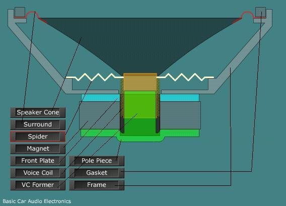

L_B_M paaji, would you happen to have any cross sectional pictures of a coaxial.
Also, Do you have any internal pics of any coaxial speakers.
I'm trying to get a thin tube to access the centre and blow the dust out from there. For doing this I need to know how it looks inside.

Hmm..I dont have a cross sectional pic but I have some thing similar which might help you.
In the above pic the dust is stuck between the magnet and the center pole piece.
I am say it the third time. Only blowing air will not help, but blowing air and moving the speaker cone will dis allocate the dirt and this will blow it out.

L_B_M, thanks for the pic. seeing your picture I tried cleaning it and it worked.
I thought of something a little different. Since I din't have access of any air blowing device, I went and bought a frooti tetra-pak. I used the straw given with the tetra-pak and blew with all my might while moving the cone down. And voila 2 small pieces of paper come flying out.
I am now going to try it out with the 6X9 coaxials in the lancer as well. they are 6 years old and have a similar problem.

Hmm...the yellow arrow shows the place where the dust is stuck 90 % of the times as it is open in a 6x9 speaker for the mounting of the tweeter pod.
