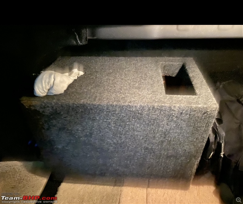

The TS-254C is a closed box (aka sealed box) subwoofer and cannot be used in a 6th order bandpass box. At best I would limit it's use to a 4th order bandpass but ideally, a 24-28 liter sealed box will give you tighter, better-defined bass at the cost of some bass volume.
Do this. Stuff some old cotton socks into both the ports/holes and see if the bass improves. if it does you know your box design is the problem.

Thanks for the reply, I knew the problem was the box. After reading your post, I went back to reading about the speaker specs and its box requirement, which states "Low-Q Design for use in Small Sealed Box (0.8 cubic foot recommended)"
I read about the wire splicing part, but I saw no other option, please suggest how this is done.
So Clearly I got fooled back in the time of no tbhp to clarify this, until now when I put this back to use. Anyway I got a weekend project to work on now.
This is the picture of the all walled box with just 2 openings, how not to design a sub woofer box!
Car Audio Advice from the Audio Gurus: Use "Search thread" before posting a new Q!-picture1.png
And the new design plan, hope I am on the right track.
Car Audio Advice from the Audio Gurus: Use "Search thread" before posting a new Q!-picture2.png

I can’t believe it’s my subwoofer. It sounds amazing now. Punch right on! Can’t believe I lived without this jugaad for so many years, of ignorant jaar. @navin
The hole was on top, not on the bottom, as my diagram.
