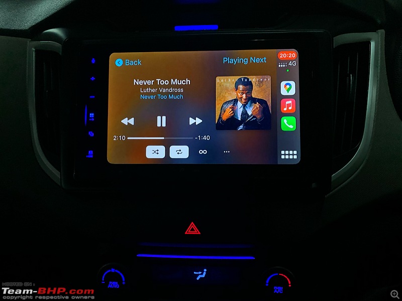

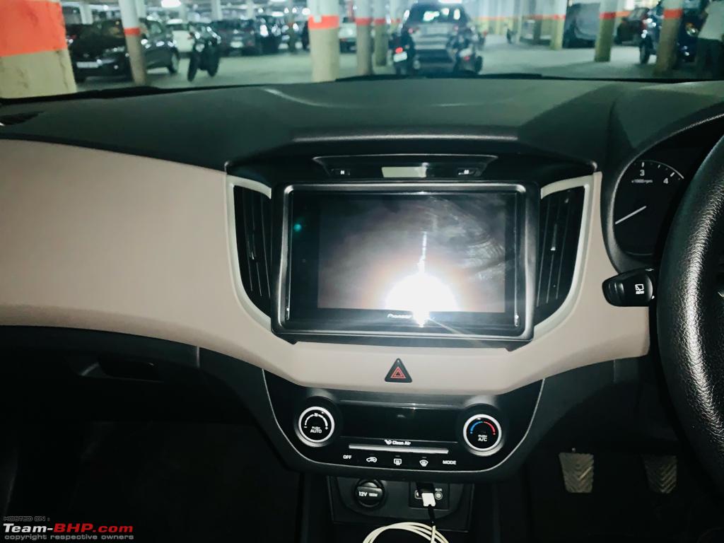

So finally managed to upgrade my HU! I have a 2018 Creta SX 1.6 diesel, and since this model was the one before the facelift, Hyundai provided the car only with a 5inch HU which had the basic touchscreen Bluetooth system. Its not a bad HU at all, but the fact is that I have had to use my mobile phone on a holder all along. So I started contemplating on changing the HU, but I was also wary of the after market look that any external HU has. In fact I scouted extensively for the OEM HU which comes on the higher variants, but did not have any luck.
Special word of appreciation for our very own audio expert, Teambhpian A4Anurag, who connected with me and explained all possibilities on upgrades.
My needs were simple, I had to get rid of the phone holder, needed a HU with Apple CarPlay, and that was it. Im no audiophile, so wasnt looking for anything significant.
After reviewing all options around, it became clear that all 7inch HUs will have the black frame plastic visible and there was no way around to avoid this. So i had sort of made up my mind to buy either the Sony AX5500 or the AX7000. However, this one Pioneer HU, 8290BT caught my eye. It was 8inches, and it also came with a Creta specific frame. But I could not get to see the frame in person anywhere and whatever images I did see were not assuring. Finally I reached out to Konark accessories in Bangalore and they seemed to have fitted some of these and they even had a you tube video of this. It did not look so bad in the video after all. My only fear was that the frame seemed to have a glossy finish in some pictures and in some videos it was the regular Matt finish. And also the price was very high. This HU and frame combo costs close to 60k, and the best offer I had was around 48k.
Anyway, I took the risk of ordering the frame, it reached Bangalore earlier on Monday this week and when I got the pictures I was relieved to see that it was the regular Matt finish! So finally I installed the HU at this store called Drift, Whitefield, since they were closer to my house. Final price was 47k, for sure I never had this kind of figure in mind and was looking at more like 25k, but after the installation I felt it was worth it. It does not have the OEM look for sure, however it looks good and the screen being big means that there is no black plastic visible anywhere. In fact it looks really good in person rather than in pictures.Car Audio Advice from the Audio Gurus: Use "Search thread" before posting a new Q!-imageuploadedbyteambhp1609347439.019029.jpgCar Audio Advice from the Audio Gurus: Use "Search thread" before posting a new Q!-imageuploadedbyteambhp1609347450.467093.jpg

Originally Posted by viXit View Post
It's a good thing that you did not upgrade to a head unit from higher models. The Hyundai OEM head unit with CarPlay and Android Auto seem to be terrible going by the experience of a4anurag. Congratulations on the upgrade. Please post more pictures in the day time so we can see the fit and finish better.
Sharing some more pictures of this installation. The frame fits quite well and it does not have the projected look that I thought it would have.Car Audio Advice from the Audio Gurus: Use "Search thread" before posting a new Q!-imageuploadedbyteambhp1609653375.470318.jpgCar Audio Advice from the Audio Gurus: Use "Search thread" before posting a new Q!-imageuploadedbyteambhp1609653429.701659.jpg
