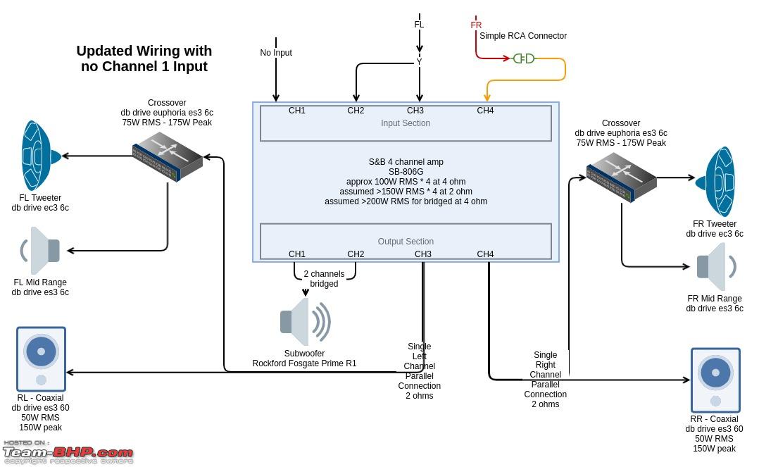

Originally Posted by sarav100 View Post
Hi #ish,]
Started debugging the issue and noticed that bass gets limited if both both FL and FR channels are connected to it's input channels - Channel 1 and Channel 2. However, if one of the input channel is disconnected, the bass returns to its full potential and becomes deep with single input channel.
Attachment 2209778
Suprised no one caught it.
The polarity of one of the sides is reversed.
Which is creating a inverted wave that is killing bass that the other side of the car is making.
Hope this fixes your issue.
I am 100% sure.
When your subwoofer jumped and got disconnected, you must have connected in the wrong polarity.
Try flipping the + and - cables on the subwoofer (the thing that got disconnected)
Your tuning is highly compromised due to the Stock head unit.
Ideally, you should have gotten a DSP instead of the JBL line output converter. That way. You would be able to tune your system and fix 100 out of 100 issues that crop up. Much better than even an aftermarket head unit.
pls do post some pics of the installation
