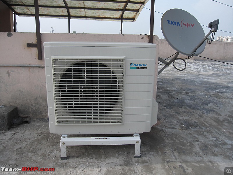

Originally Posted by khoj View Post
Anytime rana_kirti, Do post a snap or two of the machines once installed. Especially the ODU with the covers off, if you can manage to take some during install that is.
here's some pictures that you requested..
Rana.
P.S : Thanks a lot for all your help
The home / office air-conditioner thread-idu-1-.jpg
The home / office air-conditioner thread-idu-1-b.jpg
The home / office air-conditioner thread-idu-1-c.jpg
The home / office air-conditioner thread-idu-2-.jpg
The home / office air-conditioner thread-idu-2-b.jpg
The home / office air-conditioner thread-img_1541.jpg
The home / office air-conditioner thread-odu-1.jpg
The home / office air-conditioner thread-odu-2.jpg
The home / office air-conditioner thread-odu-label.jpg
The home / office air-conditioner thread-odu-side.jpg

Thank you rana_kirti, that is a neat machine inside and out.
