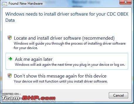

Thanks a lot for that link. Its a nice guide on how to unbrick the mobile. But I am stuck. Here is the sequence of events:
I downloaded all the necessary things for the flashing.
- Samsung USB Drivers (Installed on my laptop with Win Vista)
- Odin v4.38 and v4.42
- Samsung Official ROM
- Samsung Kies (Installed on my laptop with Win Vista)
Now the problem starts when I connect the phone to my laptop. I get multiple drivers installation pop ups. Even though Samsung Kies is installed and Drivers are installed, the pop ups keep on coming. I have tried searching for these drivers on Google, but not luck. Screenshots below.
Android Thread: Phones / Apps / Mods-1.jpg Android Thread: Phones / Apps / Mods-2.jpg
Android Thread: Phones / Apps / Mods-3.jpg Android Thread: Phones / Apps / Mods-4.jpg
Android Thread: Phones / Apps / Mods-5.jpg
Further to this, if I select the One Package option and browse to the downloaded .md5 file, Odin crashes. I tried with v4.38 and v4.42 as well.
Screenshots below. I have lot of free space on the HDD and no applications were running when using Odin. Still it crashes.
So basically Odin doesn't detect my mobile and crashes the moment I select the Samsung official ROM file.
Any idea what's happening with Odin ?
Android Thread: Phones / Apps / Mods-6.jpg
Help Please !!!

I had a similar problem with the latest version of ODIN when I was flashing the stock ROM on my Note. Can you try the older version (http://www.android.gs/download-odin-1-85/) and revert back if it works?
