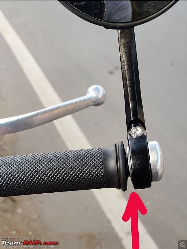

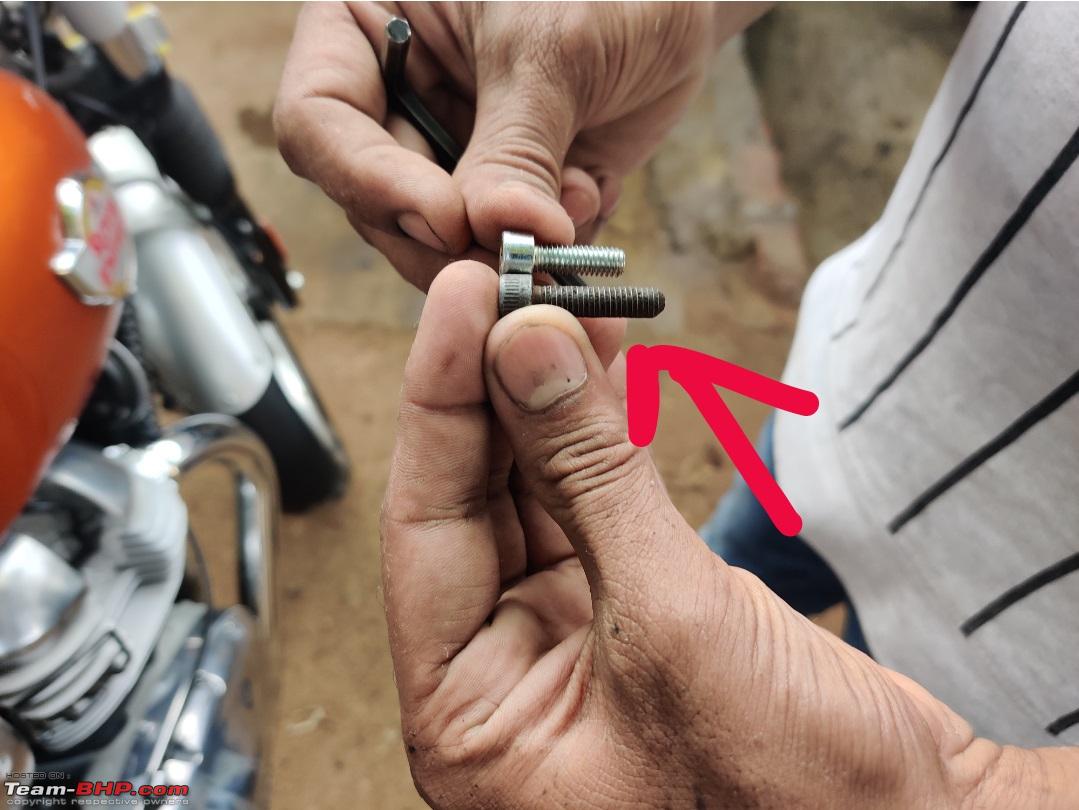

Installing the RE Bar-End Mirrors on the Int650:
The problems that come up when installing the RE Bar End Mirrors are:
1. The RE Bar-End Mirrors don't come with bar ends.
2. In order to use the existing bar ends of the Int650 you would need a longer screw and a thin washer. These are needed to avoid the accelerator getting jammed.
You have two solutions:
1. Buy a cheap INR500 or lower bar end mirror that has its own bar-ends. Use the bar-ends with the RE mirrors.
2. A slightly longer version:
-Procure a longer 5mm screw such as the dark one below. I've put it adjacent to the stock one on the Int650.
Ridden: Royal Enfield Interceptor 650 & Continental GT 650 Twin-screw-scale-11.jpg
-Get a large but thin washer. Try to see if you can get one with a larger hole. I've added the washer pic below on the seat for scale . Unfortunately, didn't have anything else for scale.
Ridden: Royal Enfield Interceptor 650 & Continental GT 650 Twin-washer.jpg
The reason I suggested one with a larger hole is because of the itsy-bitsy protrusion on the handle that blocked a washer with a smaller hole from getting close. The protrusion is a lock for the stock bar end.
Ridden: Royal Enfield Interceptor 650 & Continental GT 650 Twin-protrusion-11.jpg
Perspective of the protrusion:
Ridden: Royal Enfield Interceptor 650 & Continental GT 650 Twin-protrusion-22.jpg
Because of the protrusion and my small hole washer- there is a slight gap on the right end post installing. Hardly noticeable but you know it is there.
Ridden: Royal Enfield Interceptor 650 & Continental GT 650 Twin-gap1.jpg
Now, both the screw and washer are needed to create space between the accelerator and the mirror else the accelerator gets jammed. You cannot do away with the washer and it is incredibly difficult to buy it on your own. I must've visited 20 hardware stores before giving it up. The RE guys neither had the washer nor the longer screw. Fortunately, found a good mechanic close to my house and he procured both within a day. The installation was done by Rafique from Standard Bike- Kondapur.
There is also a slight challenge on the left bar with this jugaad pressing on the grip so it has slightly bulged a bit.
Ridden: Royal Enfield Interceptor 650 & Continental GT 650 Twin-left-grip-bulge1.jpg
The closeness on the left side also led to the clutch scraping on the mirror and not closing completely.
Rafique got the clutch to move a centimeter to the right which solved the problem. He also noticed the hard clutch and fixed it as a4anurag suggested.
Finally had both the bar end mirrors functional and honestly they are much better than the stock ones both in aesthetics and function.
Ridden: Royal Enfield Interceptor 650 & Continental GT 650 Twin-bike-w-bar-ends.jpeg
I am however waiting for the cheap mirrors from Amazon to get delivered on Tuesday so that I can use its bar ends as a potential solution. My only worry is that at INR500 it might not be durable and end up damaging my expensive RE bar end mirrors.
I will probably need to re-do this again when I get my grip puppies but this is fun so I don't mind it.
rohirrim is offline   (10) Thanks
