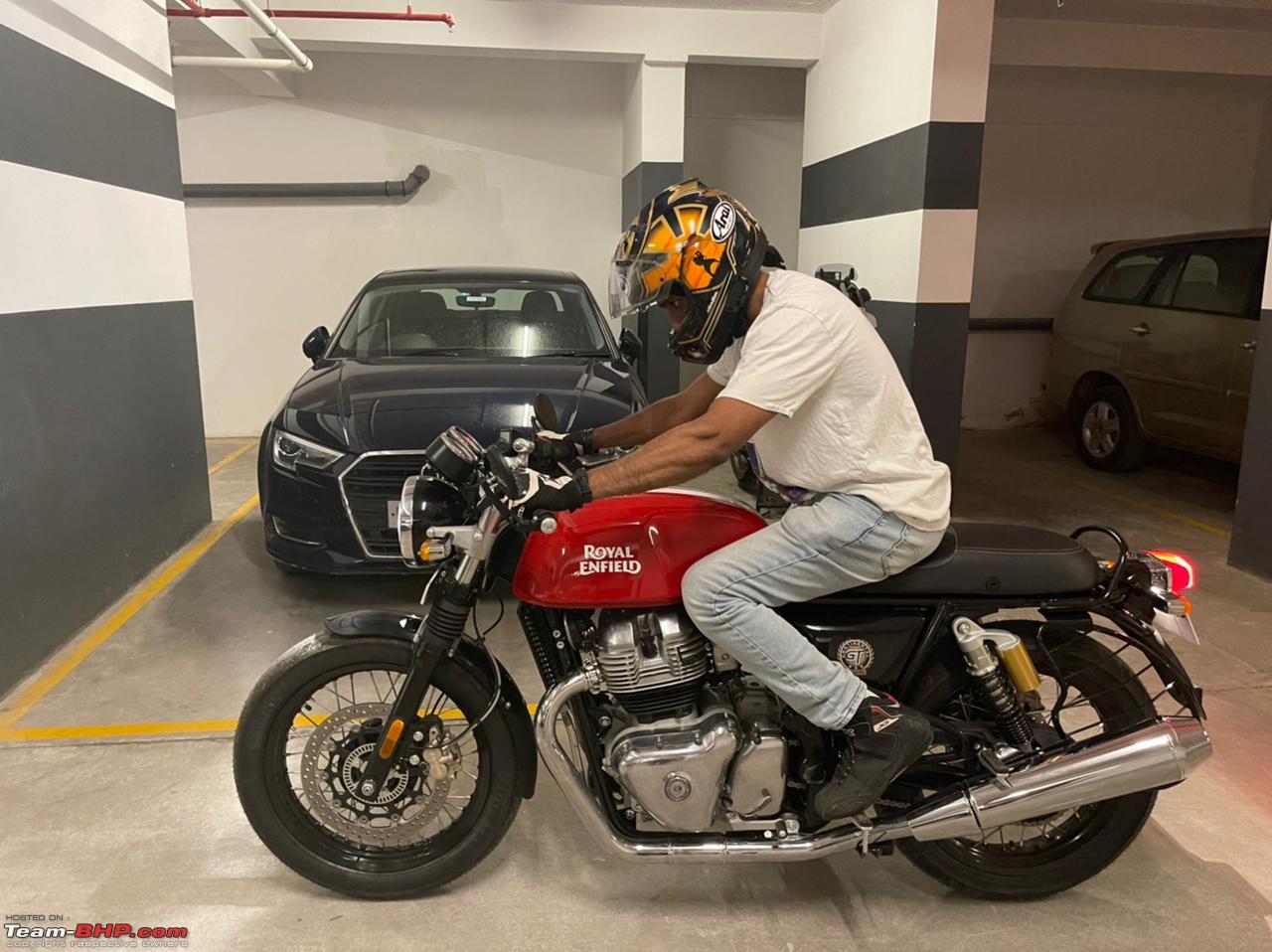

Posting out here in case any of you are in a similar situation. I booked a Dr Mayhem on the Make it Yours app on the 6th of Feb. The estimated delivery was 7th of April and at the time of my booking MiY configured bikes were being delivered within 15 days. Then the rumours started spreading about a new variant launch. I was ok with getting the older variant so patiently waited. Then the new colours were launched and Dr Mayhem was no longer listed. Acclaim Motors was the dealer I had selected for my delivery and they did confirm I would only get Dr Mayhem even though it was discontinued with no estimated date of delivery. Also I was told I could not change the colour since it was customized. This made no sense to me considering the customization I had selected apart from the touring seat would be done at the dealer and not at the factory as I had assumed. Whatever accessory you choose would be shipped along with the bike and fit at the dealer yard, this was confirmed by both the company helpdesk and the dealer.
On the initial committed date (7th April) I get a text stating RE was thrilled about launching new colours and I had to now wait till July for my bike. This ticked me off and since this was a non refundable booking it took me a lot of back and forth emails with RE before the dealer intervened and agreed to cancel the booking with a full refund. I just had to go to the showroom and fill a form.
That was my undoing, there was a Rocker Red GT on display ,on screen the colour doesn't look like much but in the flesh/metal I was floored and I had to have it. Mr Tamilselvam (manager at Acclaim) was more than happy to swap my booking around and instead of walking out with my refund I rode out a day later with my bike. Credit to Mr Tamilselvam for handling the situation very professionally and ensuring I had the bike the next day.
Ridden: Royal Enfield Interceptor 650 & Continental GT 650 Twin-whatsapp-image-20210415-18.28.22.jpeg
Ridden: Royal Enfield Interceptor 650 & Continental GT 650 Twin-whatsapp-image-20210415-18.46.09.jpeg
Ridden: Royal Enfield Interceptor 650 & Continental GT 650 Twin-whatsapp-image-20210415-18.28.24.jpeg

Congratulations, deep. Thats one gorgeous looking machine. Looks stunning in red! I am absolutely drooling over it. Wishing you many happy miles on it.

Congratulations on your new machine. Looks fabulous and I am sure you will enjoy it thoroughly. You now have a beautiful garage complete. And no ! life is not a box of chocolates but that's a discussion for another time !

Congratulations sir, there is nothing like red color, like nothing, well you would Know
Wish you thousands of safe riding with the GT.
PS: Is that shobha city basement?

Congratulations on your new motorcycle! The GT 650 looks fabulous in red and Im sure that you will have a ton of fun on it in the coming years. I hope you will put up an ownership thread for this new motorcycle. Your decision making process and the inevitable mods to make this an even better bike for your usage, will be a great help to all of us, just as your Ducati thread has been.
