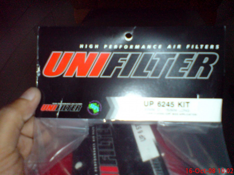

Here are the photos of the filter. The contents are: 1) Air Filter, 2) Air filter wrap, 3) Breather pod filter and 5) The Filter-Fix oil.
Except for the brand name, UNI & UNIFILTER i don't think there's any major difference between these two makes. They are different companies, Australian is cheaper and the foam actually feels sturdier than the UNI i had before.

Check out their website here: Unifilter Australia Foam Air Filters for Economy and Performance

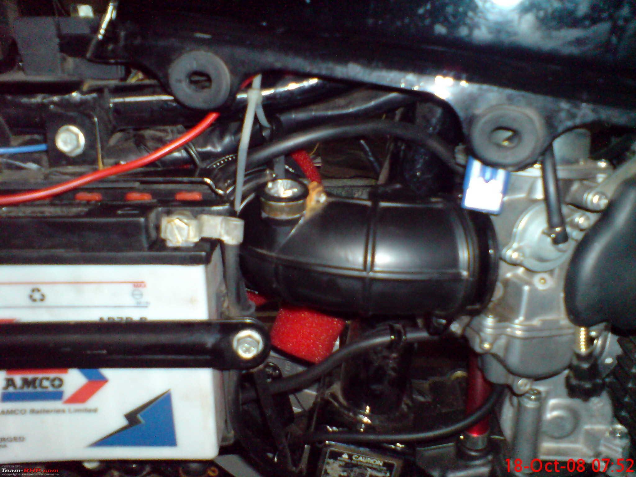

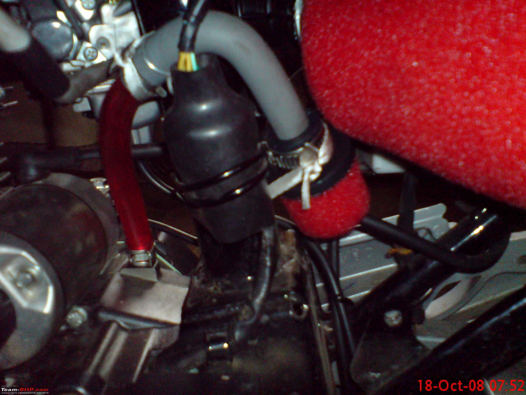

Here are the filter installation photos. As you can see i have retained the stock curved pipe, the filter is mounted on the pipe. You can also see the breather pod installation. I have tied em with a nylon string as i ran out of cable ties.
From the initial riding impression the filter seems to have really improved the performance, midrange to top end is strong. I have upjetted to 140 mains and 40 pilot.
