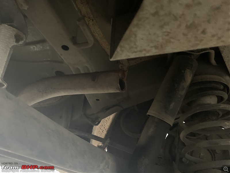

I faced the infamous exhaust pipe issue in my dad’s i10 yesterday.
Car started making some noise 3-4 days ago, there was some power lag also. So I decided to take it Hyundai service centre today in Indore.
Today morning I started for Harsh hyundai, 2 kms from my parent’s house in Indore. After few 100 metres from my house I heard a big noise of something falling from underbody of the car, I quickly stopped the car, got down and saw that the silencer is hanging from one end and kissing the tarmac from another. It got totally detached from the exhaust pipe.
Called the local mechanic, he came quickly and helped in removing the silencer completely , he assured that rest is fine and a small welding job should be good enough to attach the silencer with the exhaust pipe.
I drove to Hyundai service centre, there I was told that exhaust pipe and silencer both needs to be replaced. Exhaust pipe is all rusted and silencer also is in bad shape. I also went under the car and saw that Exhaust pipe was all rusted ( could see it from broken end)
I then decided to get the job done at local shop as I was not ready to pay 8k just for the pipe. Silencer also looked in good shape to me and there was not odd noise or black smoke coming out of it.
Went to a local gas welding shop, they specialise in silencers, they removed the old pipe and showed that it is actually rusted from inside. I could see couple of tiny holes after the cleaning it from outside.
There workshop had lot of exhaust pipes,we selected one which was in good shape and no rust (though it was not new), they replaced the pipe , gas welded from both the ends. I took a small test drive, no noise now. Payed ₹1900/- for the pipe and there service and returned back.
A new pipe would have costed me 10k atleast, hoping that this local job will serve good.
Hyundai Grand i10 : Official Review-03283ee8a1d54030a286841ca94e2937.jpeg

@INJAXN,
are your rear shock absorbers leaking ? is the ride quality very spongy ?
venkyhere is offline

Originally Posted by venkyhere View Post
@INJAXN,
No, did not notice any leakage from shock absorbers or anywhere in the car.
Ride quality is also fine.
Do you think there is a linkage between broken exhaust pipe and shock absorbers leaking?
I was referring to the way the rear shock appears in your pics. There is no just caked up dust, but dust seems to have mixed with some fluid to form grime like substance on the shocker's outer shaft casing. Can also see something shiny as well.
